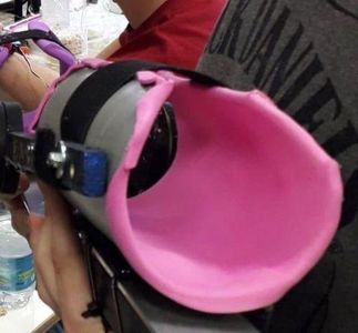

Step 2: Enclosures for the Arm
Cut a circular section of about 1/5 of it out of the two plastic tubes.
Drill two holes in the middle of the smaller tube at about 5cm away from each other. Do the same to the bigger tube, ut keeping the holes at 10cm away.
Using hot glue, attach foam on the inside of them.
If you'd like to, wrap colored cloth around the outside of the tubes, aways using hot glue.
Cut two wooden rectangles 6x4x0.5cm and cut section of 4x2cm out of them. Drill two holes a couple of cm away from one side of the tubes, at about 5cm of distnce from each other and do the same on two corners of the rectangles. Attach the two rectangles to the tubes using screws and bolts.
