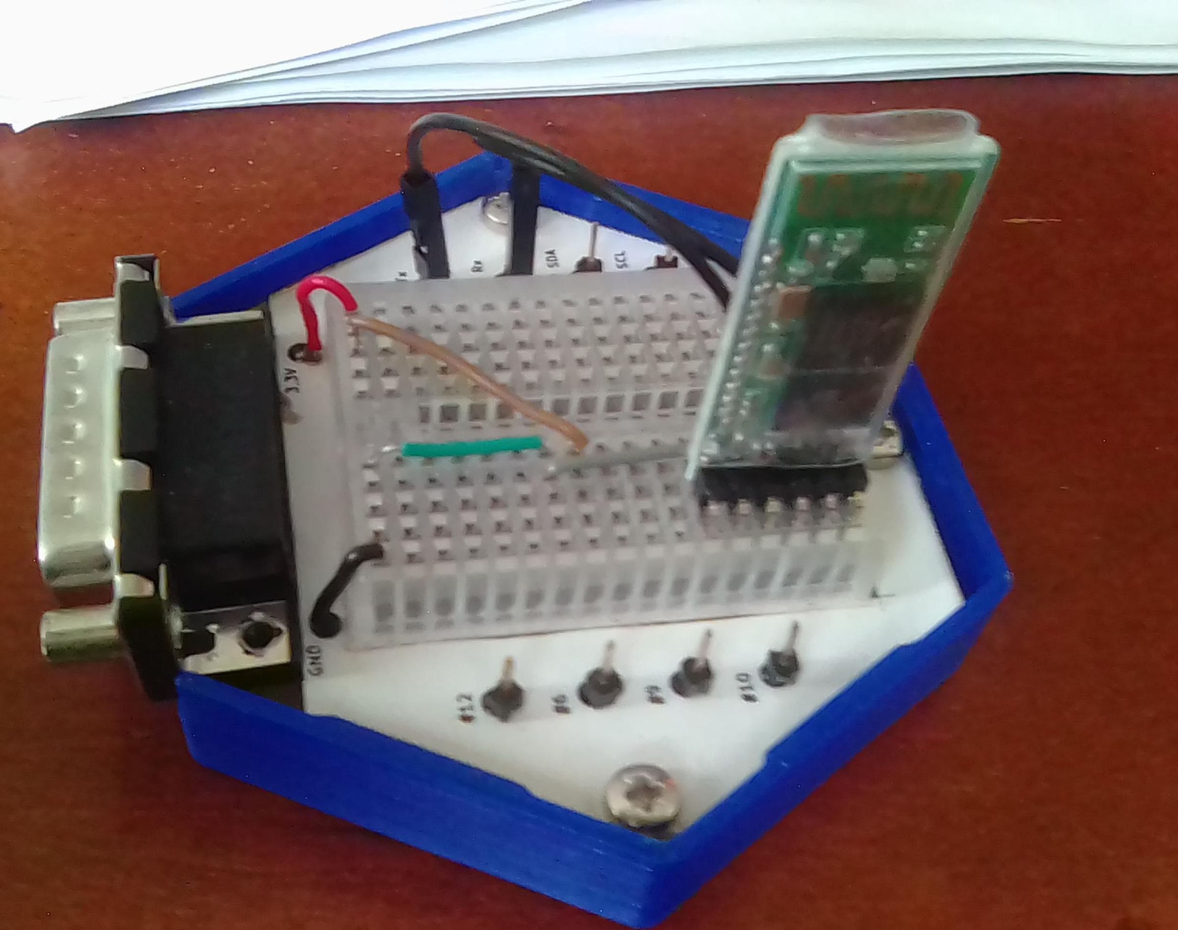

Step 4: Soldering and Mounting the Board
First you have to solder the DB15 connector (1st and 2nd image). Beware when inserting the connector in the printed board, tolerances are very tight, and it's easy to bend/break a pin. Be precise when soldering, as pin layout is quite dense.
Then, just bolt the APC onto the board (Images 3,4), this will ensure electrical contact between the APC and the board. For fixing the board, 6 mm long, 3mm screws just work nicely (sorry, I am not familiar with drunken lobster's units :-). Apparently 1/8" screws are the closest in dimensions, but I could not test).
The case of VBatt is a bit peculiar, as direcly screwing onto the case does not always ensure good electrical contact. So the choice is to cut the 4th support of the case (see Step 3), and put a screw + nut (Red arrow on Image 4).
Note: to avoid potential shortcuts, you may also protect the circuits at some places were screws are very close to circuit lanes. You can just use scotch tape (see Images 2 and 4).
Test and re-test to check that all connections with DB15 are OK, and that no shortcut did appear.
Finally, screw the board into the case, using the 3 remaining holes and 3 supports (Image 5) and put the cover (Image 6).

As an example, the image shows a "test board" developed to check that everything is fine with the "motherboard" :
  1. Red and green leds are lit if VBatt and 3.3 V are OK.
  2. A Microbot MR002-001.2 USART <-> RS32 converter permits to test the serial port #0 and #1
  3. A 3.3V SR04 ultrasonic transducer is connected to #10 and #9
  4. Two 5 kOhms potentiometers are connected to #6 and #12 to test anolog inputs
  5. an Adafruit Quad Alphanumeric 14-segment Display is connected to I2C, 5V for powering leds, and 3.3V to set the logic level for communication to the Playground
One just has to make the connection from the DB15 to the breadboard. One can use Dupont cables, here an old hard-disk cable had been modified. In a next part, we will see how to design extension boards.
