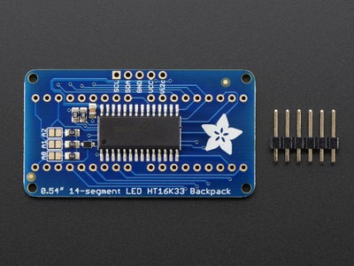

First, a 14-segments display is to be added. To connect it to the APC, we need (Figure 1, from Adafruit website):
  1. SDA and SCL for data communication
  2. Ground and 5V alimentation
  3. This Adafruit I2C 4-digit alphanumeric display is powered in 5V, but can work on 3.3V or 5V I2C level. As the APC works in 3.3V, we connect the Ui2C pin to 3.3V so as to fix I2C logic level compatible with the APC

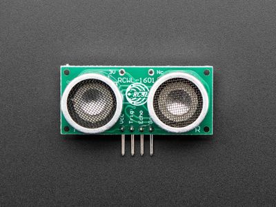

The HC-SR04 sensor (Figure 2, from Adafruit website) will be used to mesure distances.
One must connect the ground, and it must be powered in 3.3V to deliver 3.3V signals for the APC.
Then, a choice is to be made to connect the signals, here, APC pin #10 willl deliver the Trig signal to start the HC-SR04, and pin #9 will receive the Echo signal, which is a pulse, which width is directly linked to the distance via the speed of sound (with a factor 2 because it's an echo, the signal goes from sensor to object, is reflected, then goes back to sensor).
To simulate two analog sensors, pins #6 (A7) and #12 (A11) will be connected to two 5 kOhms potentiometers delivering variable tension on their output or so-called “collector” Pin 2, when their Pin 1 are connected to Vin (3.3V) and Pin 3 are connected to ground.
