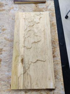

We set up how the wood was going to be cut for the detail of the world by using a program called VCarve. We used a ¼ ball nose for the roughing path, and we used a ⅛ ball nose for all the fine details. We also put some borders around the map so we can see the overlap.
Step 5: Action!
We loaded the 1/4 inch bit into the CNC and loaded the wood up, set our origins and as soon as we pressed that green button we were off to the races. After 3-4 class periods we would have the finished product, well the finished milling there was still resin and paint to go.
Step 6: The Good Kind of Stain
After the milling finished we proceeded to stain the sides and bottom to add to the aesthetic of the piece in its bland and cut out appearance.
Step 7: What Borders?
The map inset had some issues with cutting, our code went over the edge and so we decided to have a frameless world, we cut off all the edges of the map and used them as the test pieces for our paints.
