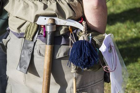

Step 8: Step 8: How to Carry This Thing?!
Well... good one!
there are several options for this.
  1. you can carry it in your quiver if it fits there
  2. have somebody else drag it along all the time
  3. stick it in your belt
  4. make something to hold it!
YAY more making!
well... its pretty easy, you just need a ring that is large enough to accommodate the handle, but not to large so that the hook might slip through it. rings of a Maglite holder(those big ones) are pretty good for the task.
but with any ring and a piece of webbing or even a simple rope you can make something yourself ;) the sky is the limit!
just make something comfortable.as seen in the picture is my way of carrying it. i used some aluminum tubing wide enough to easily fit it in. this was attached to my belt via copper wire because i didnt had anything else. you could also make a belt loop with webbing.
