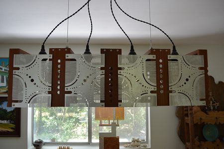

Introduction: Art Deco Dining Room Light Fixture
This project will take you through all of the necessary steps to design and build your own art deco light fixture. You can follow my configuration as closely as you want or vary it to suit yourself. For example, the dimensions can be up to you as well as the shade design patterns, number of light bulbs etc. I chose redwood and aluminum as the basis of my design but you can substitute materials as you like to make it "your" design.
Although a little tedious to make because of the complexity of the aluminum shade panels, your design can be as simple as you like. You could even buy perforated metal for example and not have to cut a design at all. The great thing is that results can be spectacular and really become the center piece of the area you wish to illuminate. Mine surely did as you can see from the photos.
Please consider one thing about this design through out the project so that you will always know what part configuration goes where. The shade panels are asymmetric so you will note that as you look at the light, every panel is the reverse of the one next to it. So you make 10 panels all the same but as you assemble the light, you install a panel and then flip the next one over and install it as you work your way around the light. If you make a simpler symmetric design you will also not need to have all of the extra part configurations that are necessary.
I HOPE THAT YOU ENJOY WORKING ON THIS PROJECT AND TAKE GREAT PRIDE AND SATISFACTION WITH YOUR RESULTS.

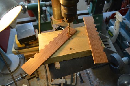

Step 6: Making the Wood Vertical End Pieces and Assemblies
The wood pieces and dimensions I have in the bill of material work for 6" x 8" aluminum shade panels and the 4" x 30" aluminum top bracket. Should you decide to use larger or smaller shade panels, you will need to adjust the dimensions of the other pieces. See the attached PDF file for detailed drawings of my design.
The end pieces are made by using a 3 1/4" x 9" x 1/4" thick piece of wood and drilling the hole pattern down the center of the part per the drawing. You will also need to drill the mounting holes along each vertical edge. You can then cut the part in half by cutting through the center of the board and thus through the center of the holes to create 2 parts. You then bevel the edge that has the half holes at a 45 degree angle on a joiner or other appropriate method.
Simply use the drawings to measure, cut and drill each of the 4 required configurations in the quantities listed on the drawings. You should end up with 8 total pieces.
Next cut the 2 end top pieces from 5/8" thick wood being careful to size the recess (rabbit) cut outs where the other parts will be fitted in and glued.
Assemble the 4 end pieces and 1 end top piece by first gluing the beveled end pieces together first and then glue these to the top end piece. It is important to remember that each end assembly is different (mirror image). See the pictures of the end and side views of the assembled light to see the differences.
Use 120 and 220 grit sand paper to finish the wood after the end assemblies glue has dried.
I like to use a clear oil base finish and sealer such as a Danish oil finish and sealer.

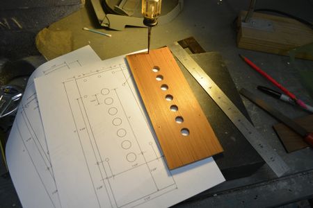

Step 7: Making the Vertical Side Pieces
There are (6) wood vertical side pieces made from 3 1/4" wide by 9" tall by 1/4" thick in 2 configurations of 3 each (refer to the drawings).
Drill the (7) 1/2" holes, (3) 11/64" top holes and (4) 11/64" side holes in each one per the drawings.
Sand with 120 and 220 grit sand paper and finish with a Danish oil and sealer after assembling to the top wood cross pieces later.

Step 9: Light Assembly
Start by assembling the aluminum shade pieces to the 3 vertical side piece/top cross piece assemblies. The shade attaches to the outside of the assembly with a screw, spacer, lock washer and hex nut. Work your way "around" the light by attaching the next assembly and then the next shade and the end assemblies until you are complete.
Next place the top aluminum bracket into the underside of the light cross pieces and center it in both directions. You can then mark the mounting hole locations with a pencil and then remove the bracket and pre-drill little starter holes. Next reinstall the bracket and use the (1) #4 x 1/2" phillips head screws to attach the bracket.
Now you can mount your clevises and install the lanyards.
I designed and made my own clevises from aluminum but I have a small mill to make them on. You can buy commercially available clevises or make a simple one yourself. If you go to the internet or Ebay and search clevises you should find what you want.

Step 11: The End!!
Ta-dah!!! Congratulations, you now have the coolest light in the neighborhood.
