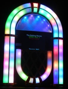

This project is for a Raspberry Pi (RPi) based music player. The case design pays homage to the 'tombstone' radios of the 1930s & 1940s and the classic jukeboxes of the 1950s. The LED 'pipes' replicate the bubble pipes on the old jukeboxes. The semi-circular widow near the top was designed to be an infinity mirror. The TFT LCD display shows the name of the band/artist, album and song title that is currently playing as well as CPU temperature and the music source. Music files are primarly sourced from a Network Attached Storage (NAS) device. Alternate sources of music files are a USB Flash drive or the boot SD card. Either an IR or Bluetooth (Classic or BLE) remote is used to control the jukebox. A bare minimum of remote control functions are available; volume up/own, pause/play, skip, rewind, mute & power on/off. One of my design goals was to have a music player that does not require any input from the user. Music is selected randomly by artist (band/group).
The LED animations are dynamic. A static picture does not do them justice. I am unable to provide a video. In order to share a video of this device's LED animations I would need original music created by me. I am not a musician, I have no original music to play. You do not want to hear me try to sing.

Features of the Art Deco Jukebox are;
  1. Addressable LEDs are used to replace the ‘bubble tubes’ used by Wurlitzer. This allows for a wide range of animations to be displayed.
  2. A TFT LCD is used to display information about the RPi CPU temperature, the currently playing music as well as the music source; NAS (Network Attached Storage), USB or SD card.
  3. The top chamber forms an infinity mirror.
  4. Bluetooth (Classic or BLE) and IR remotes are supported for simple control of the jukebox.
  5. WiFi is used to obtain music from a local NAS device.
  6. A stereo audio DAC HAT is used to provide quality music reproduction.
  7. Flexible case design to accommodate various combinations of RPi and DAC boards.
  8. The case was designed to accommodate any Raspberry Pi ‘Zero’ or ‘B’ series board.
  9. The case allows for RPi Zero boards to be mounted in two places so that Zero series or ‘B’ series DAC boards can be used.
  10. An optional MSGEQ7 audio spectrum analyzer can be added to make the LEDs dance to the music. The addition of the MSGEQ7 allows for the LEDs to become used as a ‘color organ‘.
  11. The RPi or an optional Raspberry Pi Pico can be used to drive the addressable LEDs.
  12. If not using an RPi Pico then an ADS1115 ADC board is used to interface to the MSGEQ7.
  13. All plastic case parts are 3D printed.

Two types of addressable LEDs are used. The SK6812 side emitting (also available as top emitting, like WS2812B). The WS2812B is the standard 'Neopixel' LED. Both of these LEDs use the same protocol, so there is no issue using them in the same string. The LEDs are divided into four pieces and then wired back together as a single string. Each piece has it's own direct connection to the 5V power supply. Wiring them this way midigates the voltage drop associated with long wire runs. The LED string can be driven directly by the RPi. The input pin of the SK6812 is designed to work with a 3.3V signal, no 5V level shifter is required. An optional Raspberry Pi Pico can be used to drive the LEDs.
An optional MSGEQ7 audio spectrum analyzer board can be added. The MSGEQ7 breaks the audo spectrum into seven bands and outputs the amplitude of each band. The data from the MSGEQ7 is used to make the LEDs 'dance to the music'. If present, the Pico has a built-in ADC that can acquire data from the MSGEQ7. If not present then an ADS1115 I2C ADC is used to collect the data from the MSGEQ7. Using the optional Pico results in the most responsive LEDs. I looked at using other popular microcontrollers; arduino, ESP8266 & ESP32. I chose the Pico board due to the fact that it has mounting holes and is less expensive than the ESPxxx dev kits. An Arduino Mini or Pro Micro will work, however, the limited RAM will restrict the number of different animations that can be done. A Leonardo Pro Micro has a bit more RAM, so might be a better choice. Using a Pico varient, the 'Pico Zero' is even cheaper. However, it has no mounting holes. Double sticky tape anyone ?
