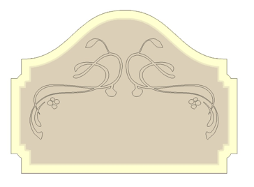

1. Select Open model and select the Vines_Grass.png file
2. Change the height to 700mm and set the origin to the centre
3. Create a bitmap to vector, reduce colours to two, switch primary colour to black and create vectors
4. Preview the relief layer in 2D by selecting the greyscale icon
5. Open the clipart library and import SignBase13
6. Centre and resize to 600mm width, paste
7. Scale relief to 25mm

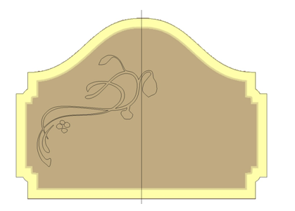

8. Insert a vertical line at 0
Step 4:
1. Transform the vine vectors (resize and rotate) to the same position as picture above
Step 5:

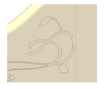

1. Go into node editing and select vine vectors
2. Cut in two places on the right hand side as shown and delete the left over vector on the right

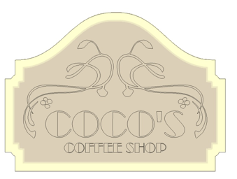

1. Create “COCO’S” text, using Broadway font, 200 height
2. Centre this and move down into position
3. Create “COFFEE SHOP” text, using Broadway font, 75 height

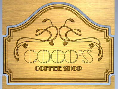

Step 8: Machining the Design
1. Create a machine relief over the sign base usingthe outside vector as a boundary
  • Finishing – 6mm BE
  • Roughing – 12mm EM (change stepdown to 5mm)
  • Define Material (default – 25mm)
02. Create an Area Clearance on the “COCO’S” text using a 1.5mm EM, start depth 12.5, finish depth 15mm
03. Create V-bit Carving toolpath on the vines and the “COFFEE SHOP” text, start depth is 12.5mm, use small v-bit 6mm
04. Create profile toolpath using the inside outer vector. Set to “Along” and set a depth of 1mm, use small v-bit 6mm
05. Create profile toolpath using outside vector. Make sure set to “Outside” and depth is set at 25mm (to cut through) use a 6mm EM
06. Simulate all toolpaths
07. Change material to Beech (H)
Go to Window > Save 3D view image to save a 3D pdf file
