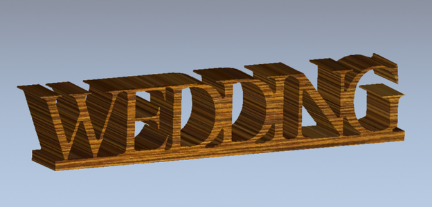

Introduction: Wedding Word Cutouts
About: We are a family of Artistic minds who not only create the ArtCAM Software, but make fun things aswell.
Create a selection of letter cutouts as a perfect gift for families, friends, on your wedding day, or even as a cool name stand.
I have seen these used at weddings on head tables, on family mantle pieces (surnames).
The nice thing about this is the design can be modified as you like, and you can even add shapes such as hearts, birds, balloons, etc.

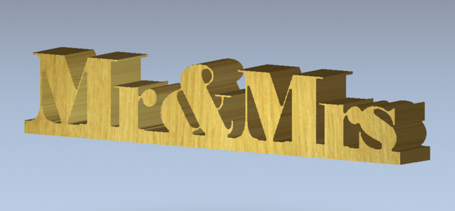

Step 1: Additional Example

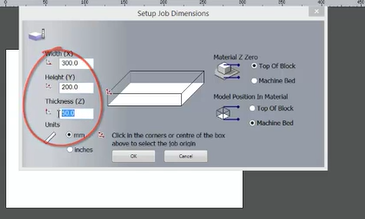

  • In ArtCAM Express software, create a material block the dimension of the design you want to cut
(In the example above I used 200mm Height & 300mm Width and a material thickness of 50mm. (This defines the size of the material using))

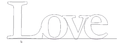

Step 3: Creating the Text
  • Next create some text (tip: use a big bold font)
  • Using the kerning option move the text closer together so the letters overlap each other
  • Then ungroup all the text
Important: Ungroup all the text (this is so that when you weld the vectors together you don't lose the centers of 0,P,Q,R,D,A etc)

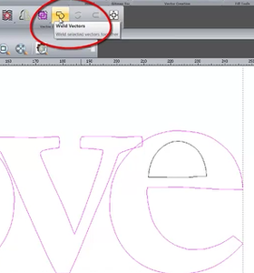

Step 4: Joining the Text
  • Select all the vectors, apart from the centers of O,P,Q,D,A,B etc
  • Once ungrouped, weld the letters together, this makes sure that the letters are all nicely joined (refer to video)
Important: Make sure that the letters cross each other in the kerning or it wont weld properly together.
Step 5: Stop It Falling Over
If the text does not have a flat bottom you will need to create one, otherwise it will just fall over
  • Create a straight line at the bottom of the text
  • Use the scissors to trim any overlapping lines
  • Join the vectors together to make sure they are closed

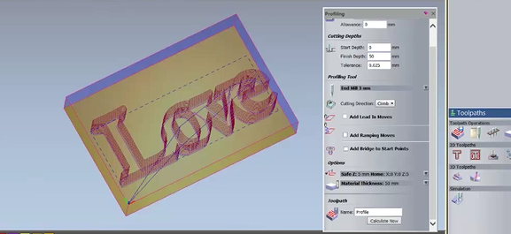

Step 6: Machining the Part
The final step is to simply machine the part, to do this;
  • Select the vectors
  • Open the profile tool
  • Choose a cutting tool (I used a 3mm Endmill)
  • Create the toolpath
  • Then simulate to check it is okay
  • Then finally send to your machine...
