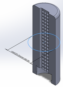

For the cutlery and cooking utensils grabbing device, first, we measured a series of different utensils so that we could get average standard measures for the length and width for the later addition of the cavity in which they are inserted. Then, we added half spheres inside the cavity to maintain the utensils fixed in a position. Finally, we added a mechanism in the opposite end to be able to open the device in case of needing to reach the other end. The diameter of the device is adjusted specifically for our user.

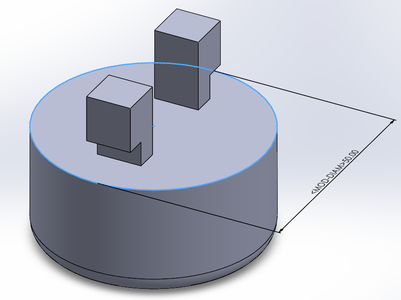

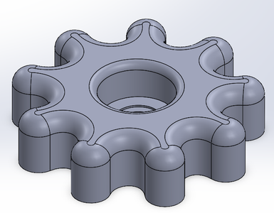

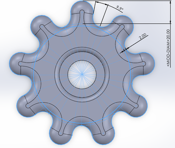

For the can opener, first, we measured the standard shape of a 200SOT can so that the device can be perfectly adjusted to the lid. Then we created the outer circumference with a diameter that makes it easy for our final user to grab it and rotate it. For the inner thread of the device, we measured the clip of the can so it can easily slide through the thread in our device. Finally, we added the star-like shape so that our final user can have a better grasp of our device using their fingers.
