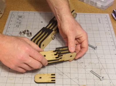

Step 3: Cut
Cut out parts per designs found on GitHub (DXF and LightBurn formats available).
STL file for ball head also available there if you'd like to print.
Step 4: Optional: Nut Knob
Using a vise, press the 1/4-20 nut into the 1/2 inch nut to create a sort of "knob." Clean the threads with 1/4-20 tap.
You could also use a wing nut, or possibly even just use a standard 1/4-20 nut, but this would make it more difficult to secure.
Step 5: Assemble
Assemble the links using carriage bolts and nut knobs. Shown here is a section that turns the rotational axes at 90º, allowing you to move your camera in a vertical as well as horizontal direction.

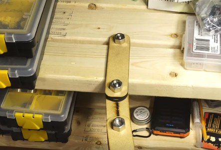

Step 6: Affix to 2x4 and Add Camera

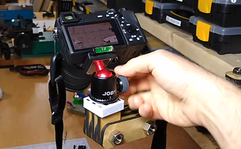

Attach camera to 2x4, using the longer links to straddle it, locking the assembly down with nut knobs.
  • Shelf setup is part of a 2x4 basics bench build [Amazon]. They supply the plastic framing, you supply lumber. Works really well IMO.
It's possible to simply screw a camera into the 1/4-20 threads on the end of the 3D-printed piece, but a better solution is to use a ball head. Different options:
  • Small Rig ball head [~ $5 eBay]
  • Joby ball head w/ quick-release [~$40 Amazon]
  • 3D-printable Joby adapter (can be used with small rig device, but I didn't find it to work quite as well as actual Joby product)
