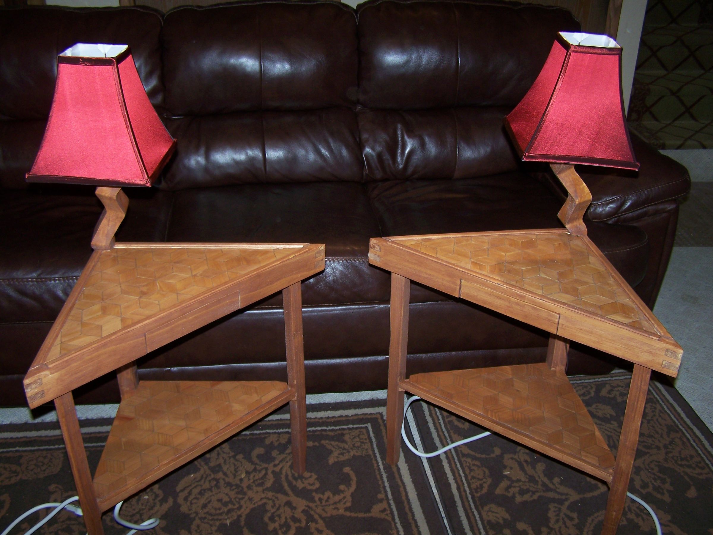

Step 20: Other Things I've Made
Here are some videos of my puzzle boxes.
