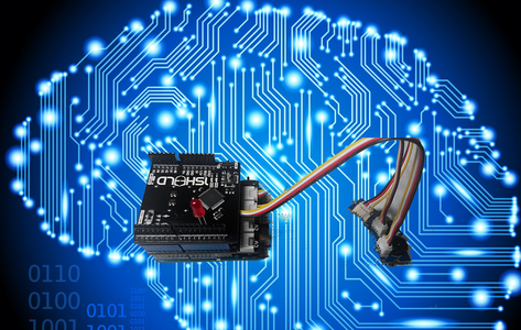

ABOUT THIS PROJECT :
Artificial Intelligence is the future of computing. A artificial intelligence system understands and performs action in a intelligent way. My project aims to build a artificially intelligence home automation system that can monitor the surroundings and notify the user in an interactive way. Current Home Automation systems have remained the same for years , to bring a change to this I have created a new method for a home automation system that can contribute to the development of the 5th generation of computing and also towards Home Automation. Speech Recognition is one of the earliest forms of 5th generation computing , thus I wrote a program in the Arduino IDE with unique algorithms to monitor and interact with the user and provide an intelligent voice assistant service.

Step 3: Hardware Setup
1) Using the 4 pin jumpers , connect the temperature sensor to Analog Pin 0 and Light Sensor to the Analog Pin 1 in the Grove Base Shield.
