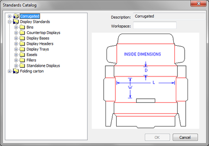

Step 2: Step 2: Selecting the Correct Standard
-After selecting run a standard a menu will pop up with different types of standard designs.
-If you wanted to you could select a display tray, but i recommend selecting a counter top display for your business cards.
Step 3: Step 3: Select the Standard
-Click on the drop down box, COUNTERTOP DISPLAYS
-Select Angular Card Displays
-Click Ok
