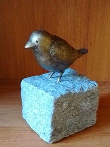

If you use clay as a template, you can also use silicone from the DIY store. It sticks so well to smooth surfaces that you can hardly remove the mould. The soft clay, on the other hand, can be easily removed and washed out. The original mould will of course be destroyed.
You can see two examples of this in this chapter: A piglet (30cm) and a bird (8cm).
