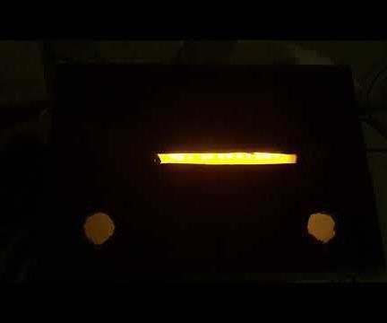

This project is inspired by @HassonAlkeim. If you are willing to take a deep look here is a link you can check out https://www.instructables.com/id/Arduino-Two-Player-Fast-Button-Clicking-Game/. This game is an improved version of Alkeim's. It is a competitive game that you can have fun with your friends. Whoever clicks faster would win the game. When I was looking at Alkeim's project I notice there is no end so I decided to add an ending to the game in order to reduce confusion. As you can see in the video, I also added a starting animation to make it look better instead of just the green light at the beginning of the game. Anyways, thanks again to @HassanAlkeim for the inspiration and let's get into how do you make this game.

You are now done for this project, what I would suggest is do a decoration as I presented in the video. Although I did a pretty sloppy job.
Step 7: Game Explanation
To start the game, both player needs to hold onto the button at the same time. And a player would countdown, after the countdown, both players would click as fast as they could until the game ended. Moreover, there are two buttons, the left and the right one. If you click the left button, the led light would move one step to the right. And if you click the right button, the led light would move one step to the left. The game would stop until the led light reaches the end of one side. Lastly, there are no rules for this game, but if you want to here are some suggestions!
