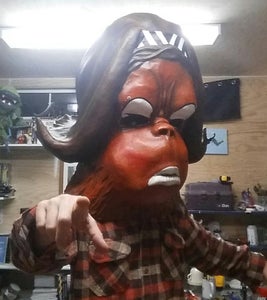

Let me introduce you to Ashley. She is the only teenage sasquatch at her high school. While Ashley dreams of a future in the fashion industry, she lives in a small town where not even one store caters to her body type. In many ways, Ashley feels like she is just biding her time until she can escape to someplace that offers more opportunities.

Ashley began with a brown base coat, just like her mother, followed by two or three coats of chrome orange over her face and neck. While that was going on, I also started experimenting with ways to streak some orange into the hairdo.
In fact, I ultimately spent more time on the simple streaks in that bubble flip than I did on her skin, but isn't that always the way?
For Ashley's complexion, I sought the same bold, saturated color on her skin, with the deep brown lowlights. But because the orange of Ashley's skin is a more natural complement to the brown, that transition was much simpler to achieve.
Adding white to chrome orange changes its character too much, so most of the gentle highlighting was achieved with just a bit of yellow.
Step 10: Make a Lady Blush
The paint job was in many ways easier than Shannon's, but it still took a lot of time because the orange has a much, much lower pigment than the blue. On the other hand, ten million coats of a translucent paint actually gives a really interesting result because of the way it interacts with light. Your eye perceives the depth, even if you aren't fully conscious of it.
I spent about four days painting her face and hair, during which the hair changed quite a few times. I experimented with a number of different streaking patterns, some of which had potential, most of which needed to be painted out. Over time, I got there.
When I felt like I was finished, with a touch of alizarine crimson on a dry brush, I blushed Ashley's cheeks.

Now things were about to get crazy. I was going for a strictly black and white motif here, with the makeup and the headband, and this makeup was not going to be subtle.
First the eyeliner, with decorative edges, and eyebrows painted high up on her real brow. I added the first coat of white to her eyes and mouth.
Step 12: The Kiss of Life
The lips were another deceptively long process. I wanted white lipstick, but you can't just paint it white like clown makeup! That color has to be sculpted on, with dark lowlights. I added an acrylic, pearl-finish medium to some of the paint, and only a few pops of pure white actually remain visible at the end.
You also have to be careful because if you don't use enough contrast, then it all disappears once you take five steps back and it just looks like clown makeup again. But if you use too much, then it will look really weird when you get up close. What I'm saying is, you might fail a bunch of times before you succeed, and that's fine. Maybe you'll succeed, but then just change your mind. I can't promise that I won't repaint Ashley again later!
I finished her eyes with some black plastic jewels that I had around, which I love, but I think it could still be too subtle. I might add some more later on.
