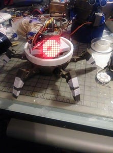

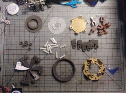

Assembly is pretty self-explanatory but here are some pics anyway.
For the electronics, you can usually put them in the top or the bottom of the head (your call), but the servo has to be attached as so. Make sure the gear is on it, please.
Step 2:

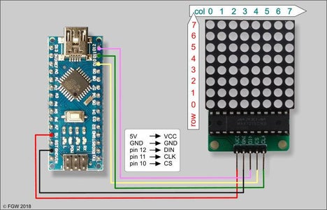

Asi is controlled by two microcontrollers, a Trinket and an Arduino Nano. The Trinket controls the movement of the eye, thanks to the servo it turns back and forth at random intervals. The Arduino Nano controls the eye. It's also random as he looks around and such, usually people assume he is looking at them.
Step 3:
Note, I have them on two small breadboards that are daisy chained with 4x AA batteries. (You can also use a lithium-ion battery 3.7 200mAh. With the li-on battery, I have had times for some reason where it would not work, so I would use two separate lithium batteries and attach them to the same on off switch so everything starts at once.)
