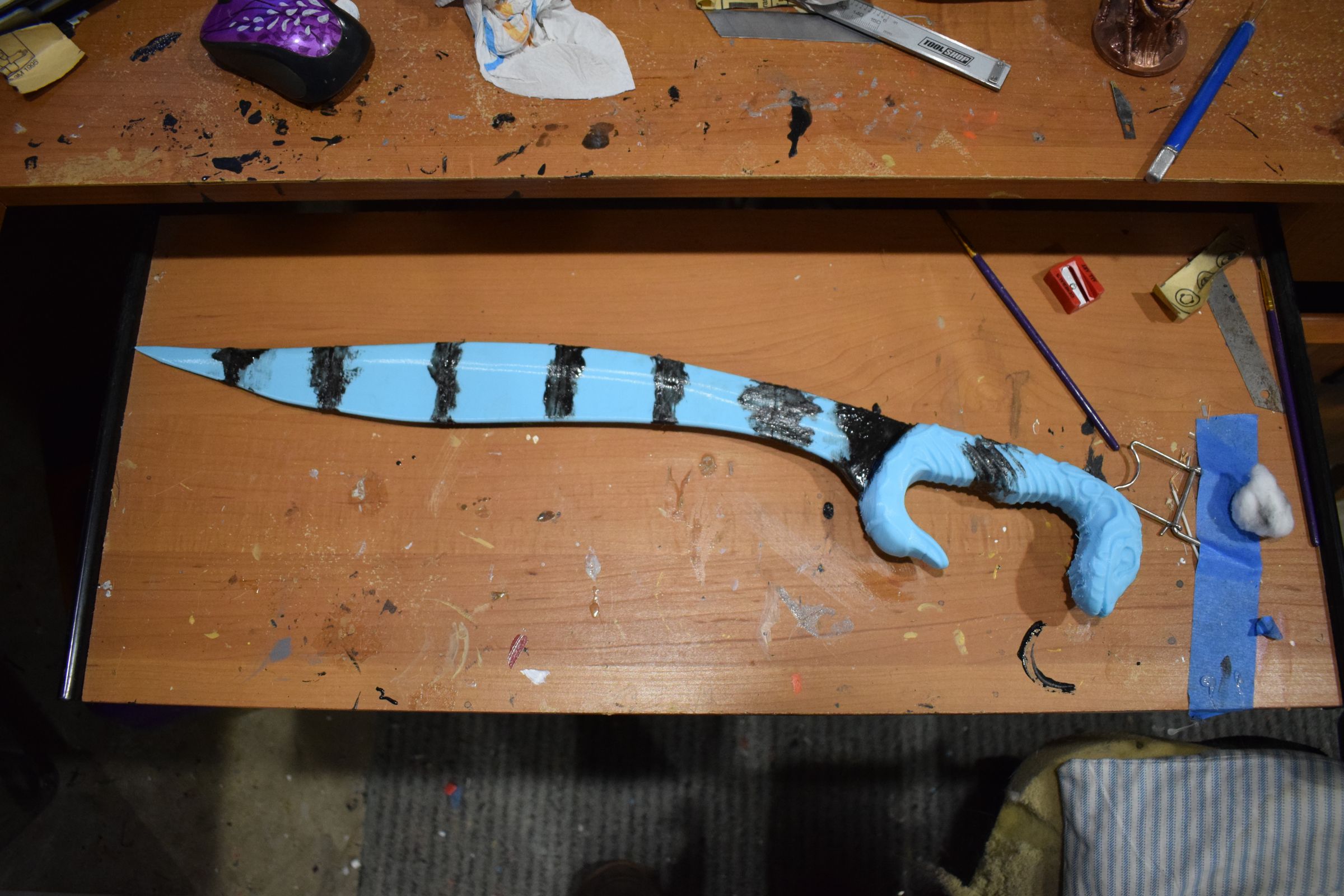

Step 3: Post Processing the Design
1). Once the glue has set completely, use a filler to fill in the seams of the design. Sand down the filler as needed.
2). Apply primer. After drying, sand the primer. I like to wet sand as it produces less dust, longer life of the sandpaper and allows a smooth surface compared to dry sanding. Apply additional primer as need and re-repeat the sanding process as needed.

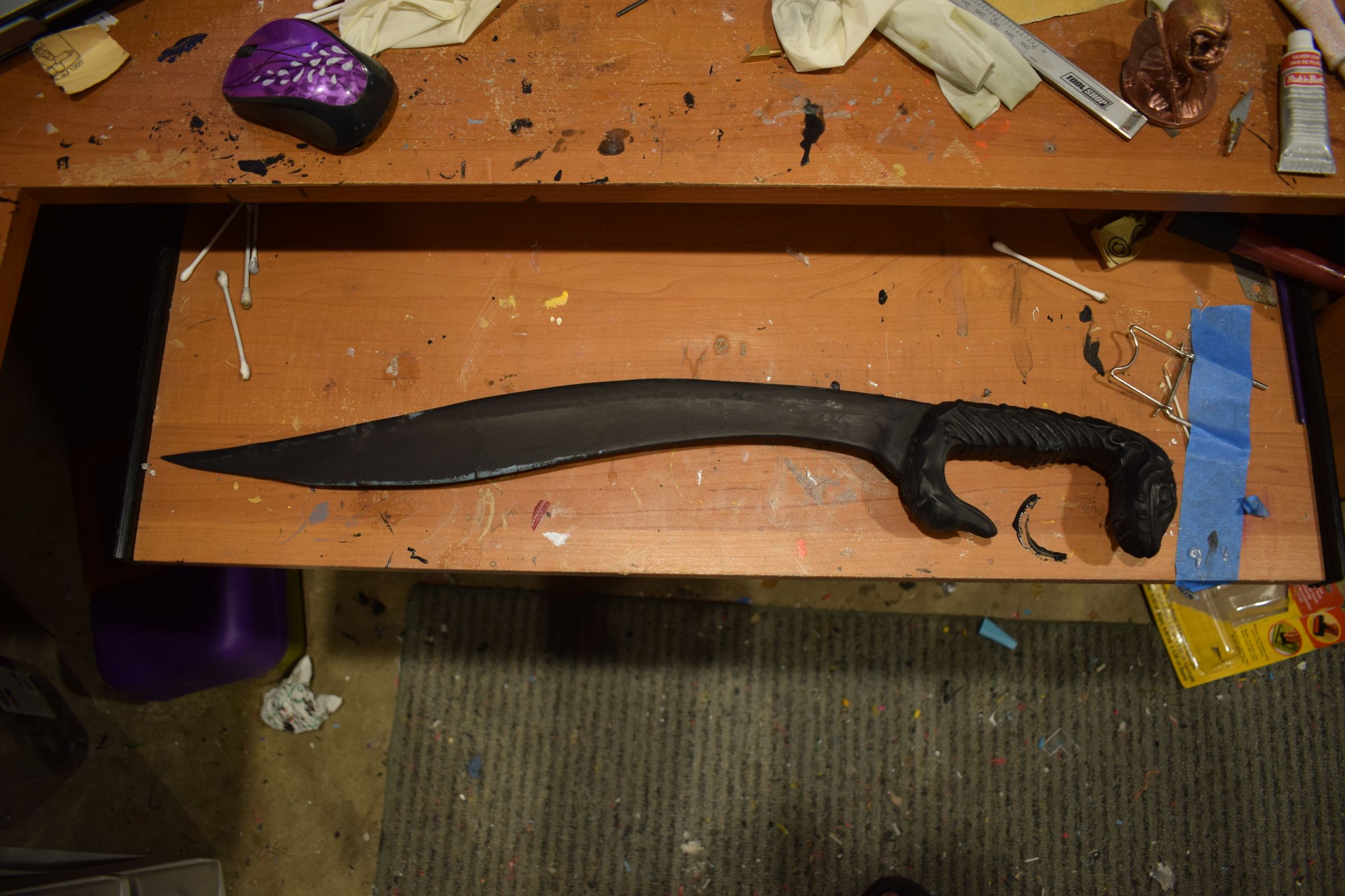

Step 4: Painting the Blade
1). In a well ventilated area, start painting the blade by applying a black base coat. I recommend wearing latex gloves to avoid getting paint on your hands if you do not hang the print for painting.
2). With the silver metallic spray paint make quick passes at a short distance away from the blade.
3). Repeat step 2 with the black paint.
4). Repeat steps 2 and 3 until you you have a galvanized metal finish. Vary the distance you hold the paint away from the blade for each color pass.

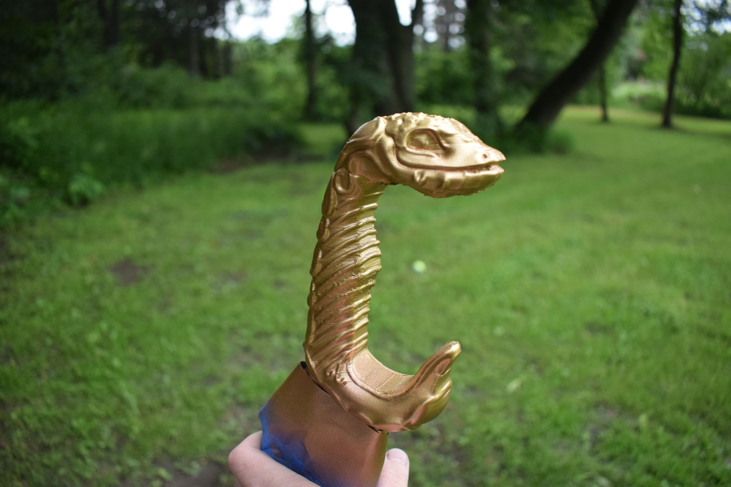

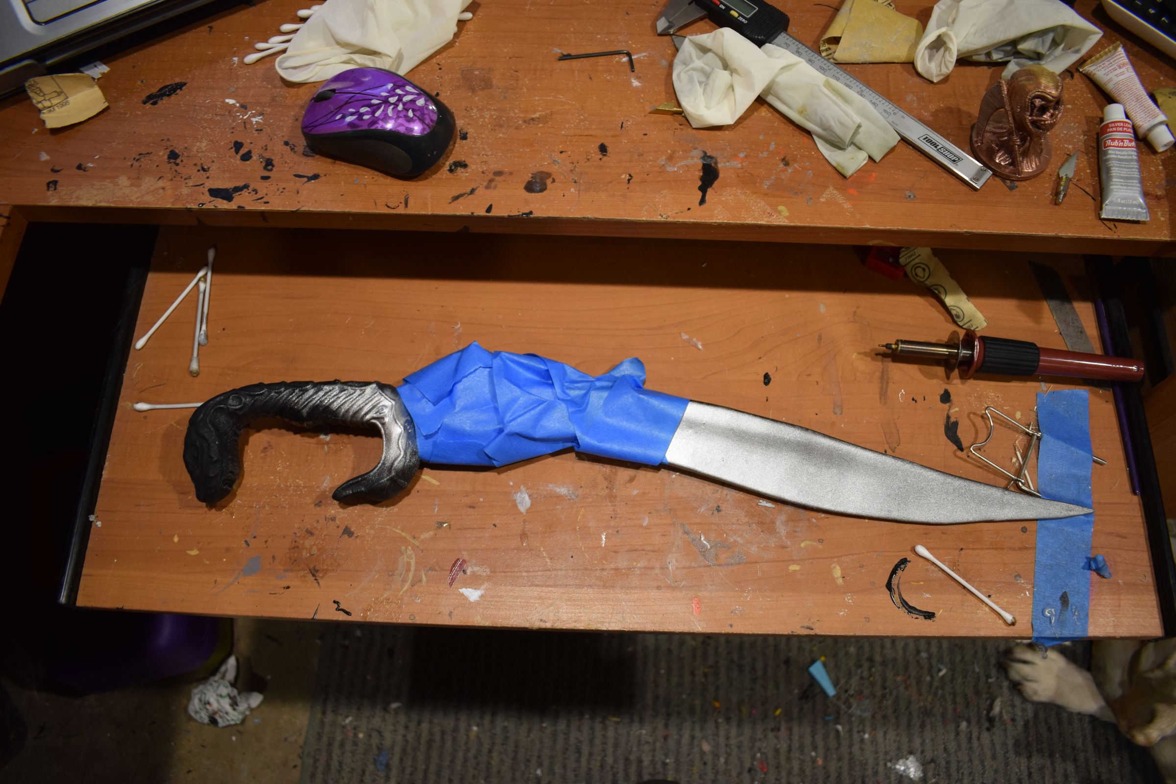

Step 5: Painting the Handle
1). Mask off the upper part of the blade below the handle. This will help prevent you from accidentally painting the blade with the colors for the handle.
2). Begin spray painting the handle. I ended up switching between brass and copper paints for a "chameleon" like effect.
