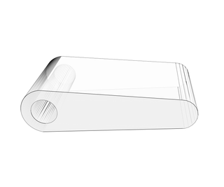

Step 2: Print #1 BODY
BODY
infill: 20-40%
LAYER HEIGHT 0.20 to 0.18 THE LOWER YOU GO THE MORE YOU GET QUALITY PRINTS IT ALSO TAKES MORE TIME TO PRINT
Shells: 0
You may need to sand some surfaces here but if the print is smooth I guess there is no need to do so.

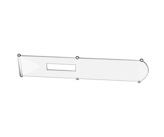

Step 3: PRINT # 2 BLADE
blade
infill: 70-80%
Shells: 0
Same as the Body and I did this so that the blade wont break of easily so as the body.
The blade will need some sanding or trimming, look closely at the pic to see where exactly
