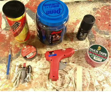

Step 1: Materials
• Slender cylindrical tube (Penn 3 pack tennis ball container)
• Wide cylindrical container (Penn 12 pack racquetball container)
• Exacto Knife
• Hot glue gun with one stick of glue
• Two strips of two inch long electrical tape
• Three feet of duct tape
• Piezo Igniter
• Fuel spray (Axe body spray)
Note: The wider cylindrical container that will be used as the chamber needs to have a twist on lid and be approximately twice the diameter of the slender tube acting as the barrel. To increase the durability of the gun, the materials of the two containers should be a hard plastic such as PVC pipe. The type of fuel spray used has negligible effect as long as it is flammable.

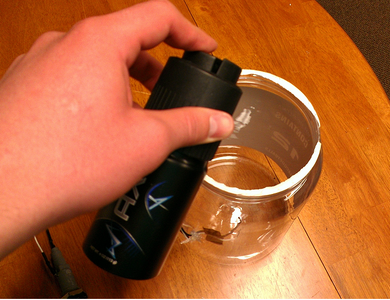

Step 12: Operating the Gun
Place the tennis ball inside the top of the barrel. The tennis ball should cover the hole cut into the tennis ball container lid.
Spray igniter fuel (Axe) into the racquetball container for about two seconds; immediately, seal the container by twisting on its lid tightly.
Note: If too much fuel is supplied, not enough oxygen will be present to carry out the reaction. Conversely, if not enough fuel is supplied, the reaction will be very weak and the ball will not travel far.
