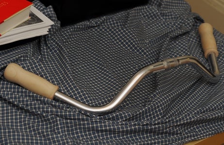

Step 4: Handlebar Idea.
Jan 13 2011
In the first photograph you can see an objet d'art, that has been hanging up on my garden wall for a few years. as such it is worth around £30,000; I am considering using it for my bike.
It is a from a very old Hercules bike and has a 22.2 mm ( 7/8")  fitting, the same as the Raleigh . . . it looks wonderful but I would have to cut off the existing levers which I do not have the heart to do.
There is a remote possibility that I could rig up the original levers but ( I have to read up again on mechanical advantage ).
I do not think that this is possible really but It gives me an idea of how it will look when it is finished.

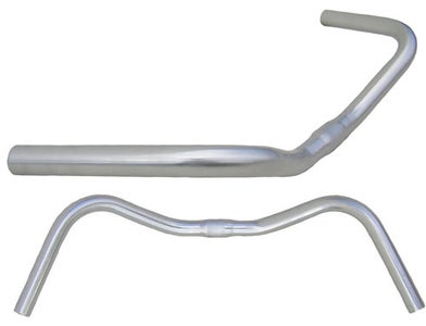

North road bars or Tourist bars are very easy to get hold of but they do not have parallel grips ( I mean that the bends are about 60°, not 90°). The Gov'nor does not have parallel grips but I think they look better.
I have not found any for sale so I am looking into buying a length of 22.2mm tubing and bending it; just two 90° bends would look fantastic.
http://www.bigdogbiker.com/forums/how/20062-howto-make-your-own-handlebars.html
The link above gives a rough Idea how to bend handlebars although I don't think heating would be necessary, but packing with sand is advisable.
The effect of the handlebars is so dramatic also makes me think that I could just buy a racer and put this style of bar on it and job done . . . but that would not be as much fun . . . .  I'm currently following about ten things on Ebay and continually thinking of how to do this bike.

Step 24: The Handlebars and Stem.
My neighbour swapped a modern stem from my bits box for a 70's projecting one; it is perfect.
After going almost crazy trying to buy a nice set of vintage bars at a reasonable price and nice shape , I just forced myself to buy an alloy set from Descent Cycles for £13. ( very good service and free postage.)
They instantly made the bike look fantastic.

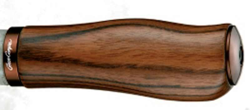

Step 25: The Grips.
I thought about grips.
Ok, leather grips seem in order, as worn by the Gov'nor . . . I had a brown leather bag that  a friend had ripped and thrown away; I cut out a patch from it only to discover that it was not real leather, but maybe this did not matter.
It seemed a  straightforward idea; to just cut a rectangle and sew it into a tube just a tiny bit smaller than the handlebar diameter and slide it on; possibly make some wooden end caps.
Before I had time my mind came up with a crazy idea . . . wooden grips . . .  .yes, I know, it's insane; they would be too hard but they would look good.
I looked on the internet to see if anyone had tried this and discovered, with a chuckle, that theses are totally mainstream . . . maybe I had seen some and forgotten but whatever they are everywhere and cost around £40.
I couldn't get the idea out of my mind . . . of course, a lathe would be needed . . . I don't have or know how to use a lathe.
Could it be possible to use a spade drill bit on a chunky bit of wood and carve away the excess afterwards ? . . . could I just drill into a grip sized branch and hope that it doesn't split.
I looked through my seasoned wood pile; nothing was really the right size.
I found a curtain pole that had been thrown out by a neighbour about two years ago; it was a bit rotten at one end but seemed about grip size.
Now, I was only trying this so that I could discount the idea and then move on to something else, I knew that it would not work.
The first two attempts split because I drilled off-centre came through the side  . . . without a pillar drill it seemed impossible but third time lucky, it worked.
The fourth was off-centre but the fifth was another success.
They were too tight for my tester bars so I filed and rasped them out.
All the time I was in a state of amazement that this had worked; I still am.
I gave them a quick sanding and slid them on.
They are actually just too loose for these bars which is OK because I want to use glue.
I will put some furniture polish on them later to bring out the grain and maybe lessen the chance of them cracking.
* After much riding I can report that these might just be the most comfortable grips that I have ever used.
