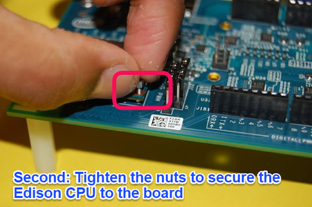

First: Connect the Edison CPU to the board.
Second: Secure the Edison CPU by tightening the nuts on the screws.

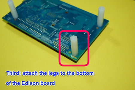

Third: Attach the legs to the bottom of the Edison board.

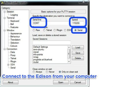

First: Connect to the Edison from your computer.
Keep the Edison connected to your computer with the USB cable.

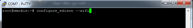

Run the Putty program.
Choose Serial type, Serial line COM7 (as seen earlier when setting up your Edison) at Speed of 115200. Click on Open
Enter "root" and press Enter then enter the password and press Enter.

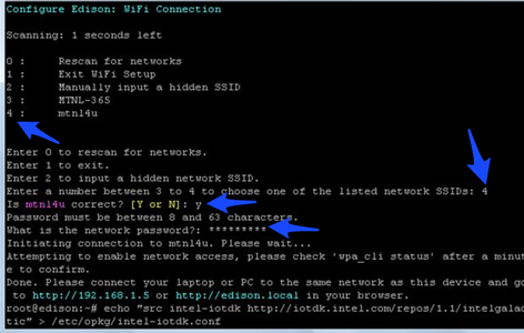

First: Configure Wi-Fi
Type the following command: configure_edison --wifi and press Enter The Edison will scan for a Wi-Fi network. Enter the number assigned to your network, enter Y to indicate the network selected is the correct one. Now enter the network password and press Enter.
You should see a message saying that the Edison is connected to your network.

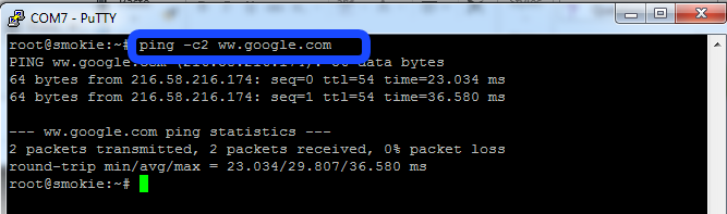

Second: Confirm you can connect to the Internet
Type the following command: ping -c2 www.google.com and press Enter
If you see a reply from www.google.com then you are connected!

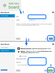

Second: Add your board to the Wyliodrin account.
Click on Add new board
Name your Edison, then enter your Wi-Fi network name and the password to join your Wi-Fi network.

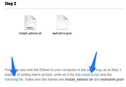

A pop-up window will come up. Scroll down and download the files in Step 2.

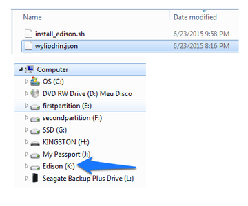

Move the cable on the Edison board from USB port 1 to USB port 2
The Edison will show up as a drive. Copy the files you just download to the Edison.
Move the cable back to USB port 1. Login to the Edison with putty
and type the command: sh install_edison.sh and press Enter.
