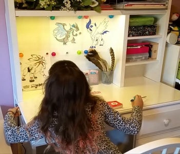

Introduction: Assembly of a Hutch and Desk and Installation of LED Lighting
This project involved a mix of engineering, woodworking, and electrical techniques. The customer purchased the desk from a local natural wood furniture store and the hutch from Ikea. The mismatch in components created a challenge in how to fasten the two together in order to make the final assembly sturdy. While at it, I opted to enhance the desk by adding built-in LED lighting so the user would not need to consume desktop space for a lamp. The LED strip also provides uniform light that would minimize shadows on the desktop.

Step 9: Final Touches
At this point, you can plug in the wall adapter and move the desk into its final position. As shown in the photo, the end user can easily reach the dimmer to adjust the brightness of the LEDs as needed.
