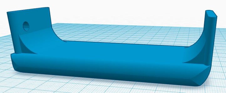

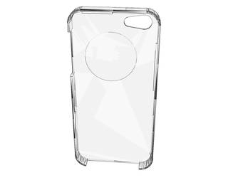

My plan at this point was to find a .stl file of a phone case that would fit (in this case an iPhone 5) , and modify it so it could hold the phone and have an appropriate size handle that replicated the old flip phone's size. I began by creating the rough shape in tinkercad, and rounding the edges.
Step 4: Print

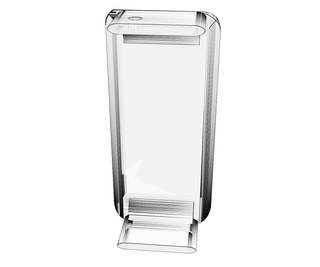

I printed the case first and tested the fit of the phone. Once I knew it would work I printed the handle separately. The first version I tested worked well, but the shape looked pretty clunky and the top corner of the handle obstructed part of the camera. This was because the case I printed had a hole for the apple logo right where I wanted the handle to attach. I had to modify the case slightly to fill that hole in the next version. After the case was printed, I printed the handle attachment and used E6000 to bond them together.

After the testing, I made some modifications to the dimensions of the handle so it would not block the camera, and added a lanyard hole, making sure to place it in a way where the lanyard would not block the camera. I also redesigned the original shape to have more rounded corners and a more aesthetic shape. Then I printed the case in it's requested green and did the handle in glow in the dark.
