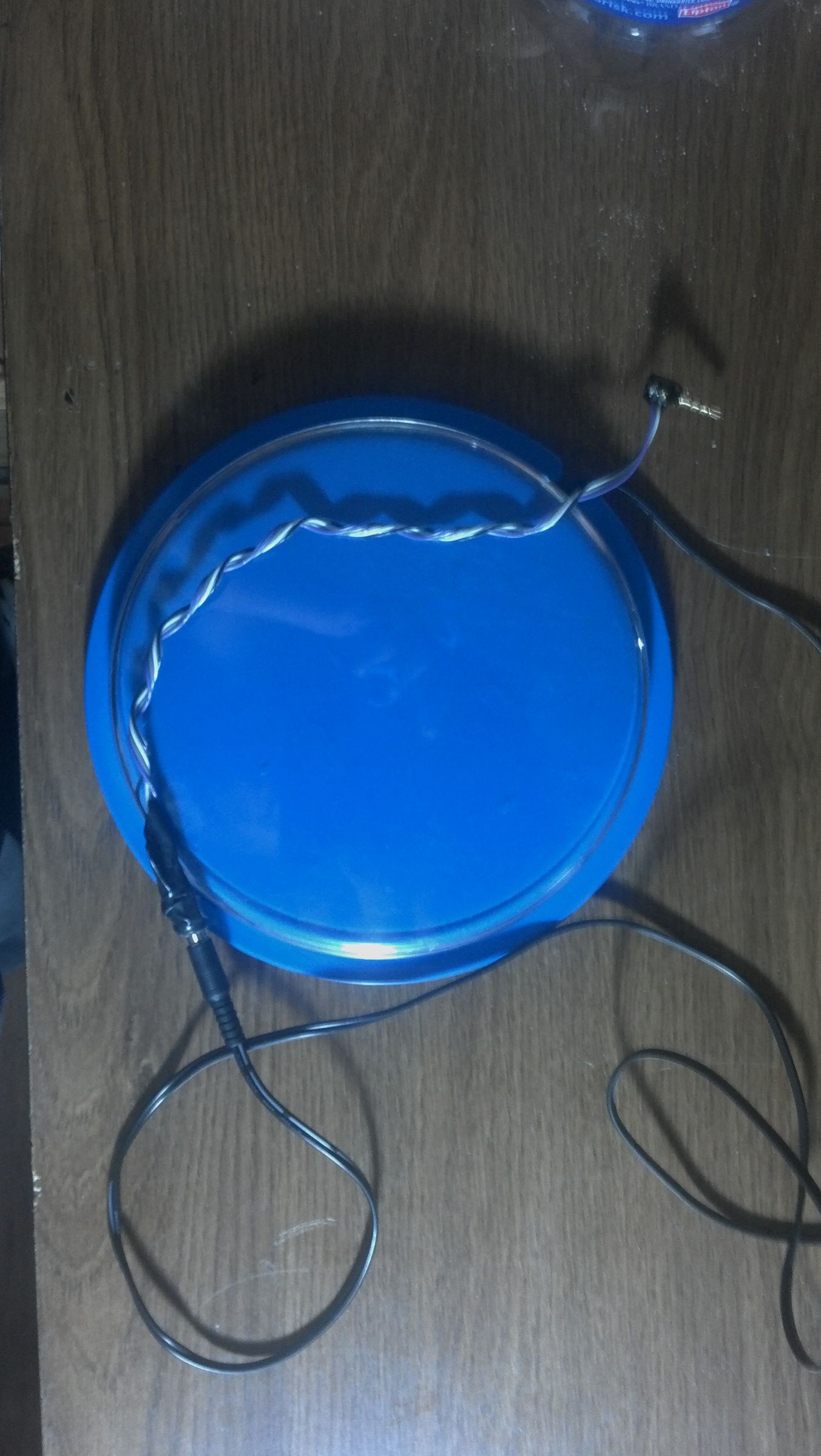

Note: The helmet drive software is designed to work with a large button that plugs in to the phone's headphone jack. It detects buttons presses, which switch between drive, calibrate, and color pick. If you do not have the button plugged in, then you may make a loud noise in the microphone, or slap the top of your helmet until it switches modes.

You can tap the phone's speaker microphone to change states, or you can build your own physical audio button by following this instructable!
