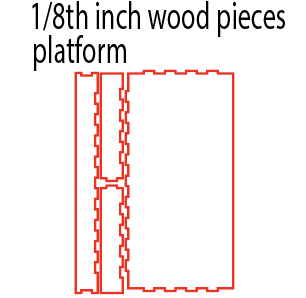

Initially, we wanted the ramp to be about 3 ft tall and use 1/8th in wood. This created a ramp that wasn't stable enough to withstand actual use, as the wood was thin and tall enough that it bowed under it's own weight. So, we redesigned the project to use 1/4th in wood and to be about 17 inches tall.
The ramp has three primary components: The platform where the ball rests, the stand that gives the project its height, and the bridge that the ball rolls down. The platform where the ball rests is the only part of the project made using 1/8th inch wood to reduce the weight. All other wooden pieces are 1/4th inch.
Included in this step is an Adobe Illustrator file with all of the ramp pieces that we used.

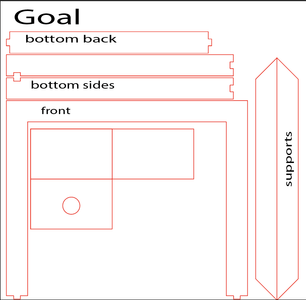

Step 9: Laser Cut Materials for Your Goal
Just as we did for the ramp, we will now cut our materials for the goal. All wooden components of the ramp are made of 1/4 inch wood. The file we used is attached to this step!
put the 3 small rectangles to the side for now. Glue the other pieces together, so it roughly resembles a soccer goal.
