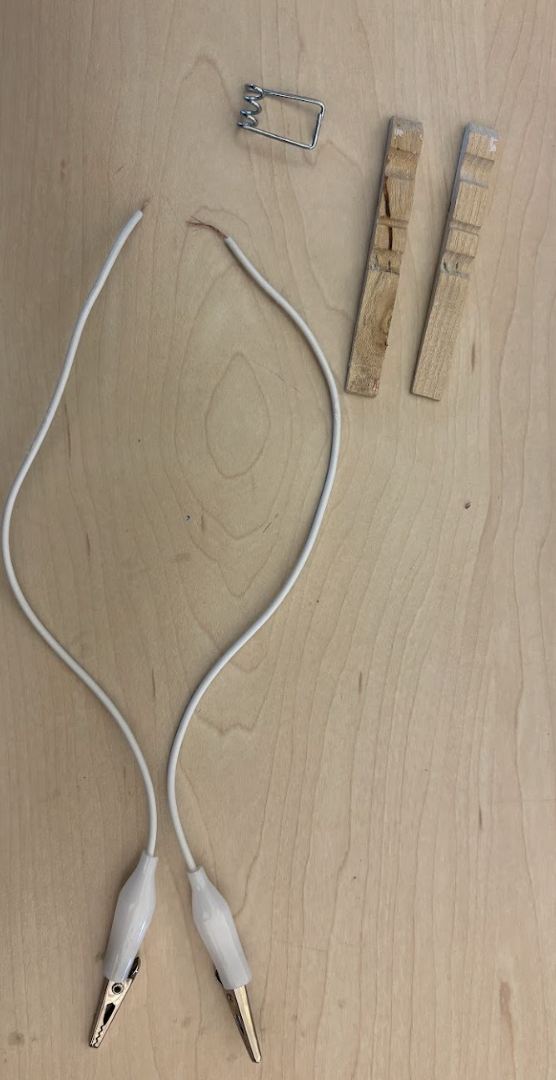

Step 1: Take Apart the Clothespin
Separate wooden sides from the metal spring
Keep all pieces

Step 2: Prepare the Wires
Strip 1/2 in off each wire using the wire stripper tool

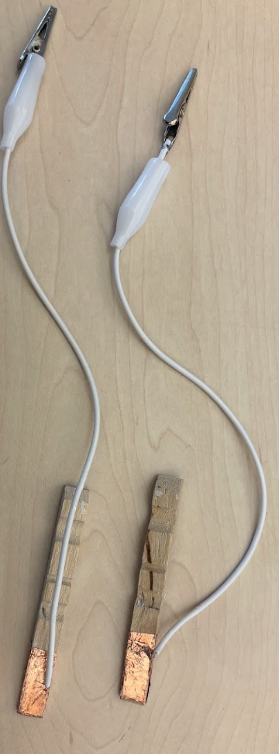

Step 3: Attach Wires With Copper Tape
Fray out stripped wire on the inside of the clothespin and cover with copper tape
Repeat for both sides

Step 4: Cover With Duct Tape
Route excess unstripped wire on the side of the clothespin cover with duct tape. Leave the copper tape section uncovered

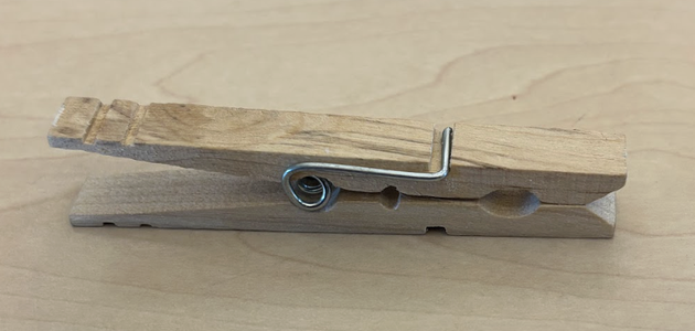

Step 5: Reassemble the Clothespin
Reattach both completed sides of the clothespin to the metal spring

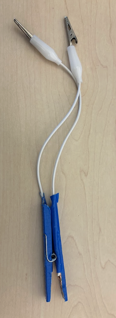

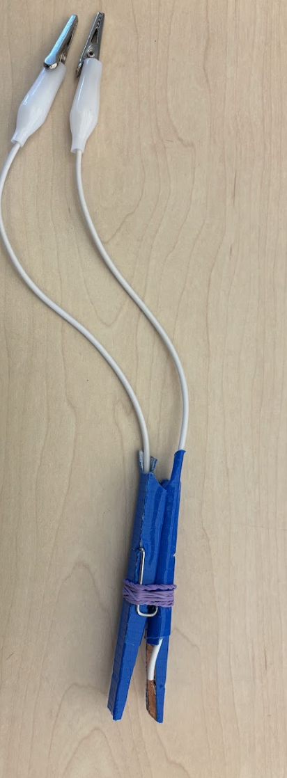

Step 6: Secure With Rubber Band
Wrap center of the clothespin with a rubber band

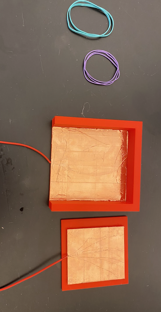

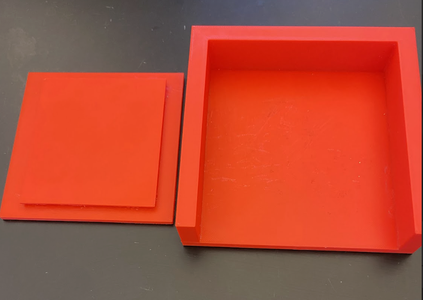

Step 7: 3D Print the Switch Housing
Start Button Switch
See STL files attached below

Step 9: Apply Copper Tape to the Inside
Fray wire and attach to 3D printed base with copper tape. Cover the surface area of the button and the top with copper tape
For button switch
Step 10: Add Rubber Bands for Tension
Add adequate attention for participants' needs
For button switch
