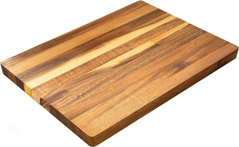

Wooden board (Cardboard works) - This will serve as the base and should weight a bit *Should be no less than 12" wide*

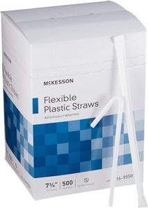

Flexible Plastic Straw

To start this off it's optimal for a weighted base, if you have a flat wooden board of any sort that works. 12'' by 8'' is preferable.

  1. See supplies above, locate the straws. You're going to want a sturdy and flexible straw, cut 1-2'' off (this is how much extra straw will poke out of the joystick.
  2. Insert 6-8'' long wire into the straw and cut the sheathing on the ends so the conductive part is available.
  3. On the upper end of the straw, wrap it with copper tape so it covers everything above the stretchable kinks.
  4. Snip a part of the lower end of the straw so the wire can come out of the side a bit.
  5. Secure straw into board/base, (It's best to drill a hole and super glue it into there, make sure it's stable and standing upright.
  6. Tape the extra wire from the bottom of the straw down, extend it 4'' away from the straw and secure it to the edge of the board(use electric tape to cover any conductivity, leave the very end uncovered).
  7. Take the wire on the edge of the board and attach a piece of copper tape and clip aligator clip to it. (This is Earth input for the makey makey)
  8. Repeat this process again for other joystick.
