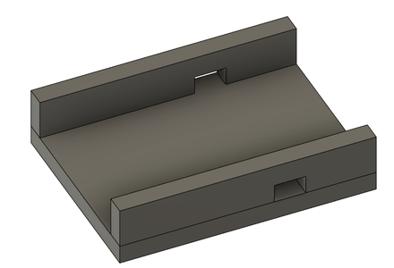

Step 8: 3D Print the Mouthpiece of the Puff Device
3D print the mouthpiece of the device using the CAD model I supplied.
Step 9: Cutting Out the Puff Device
Cut out the foam core part of the device, cutting two sides and a top and bottom. For measurements use the inner dimensions of the 3D printed mouthpiece.

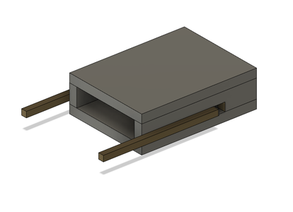

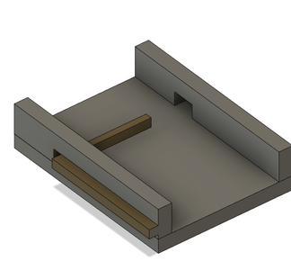

Step 11: Wire 1
Take a piece of copper wire and wire it like in the image, use got glue to secure the wire on the outside

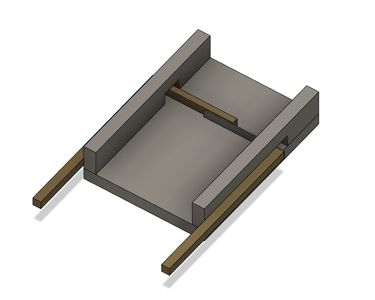

Step 12: Wire 2 and the Conductive Tape
Take a piece of copper wire and glue it to the side, then take a piece of conductive tape and glue it to the wire with the conductive side touching the copper outside of the box and hovering just in front of the copper wire inside, so that when it is slightly pushed it makes contact with the inside wire.
