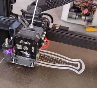

  • 3D printer (any brand) (example in image)

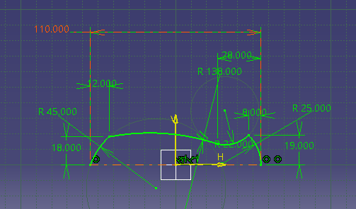

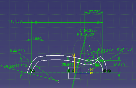

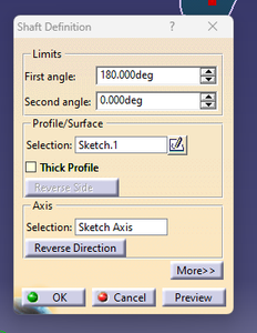

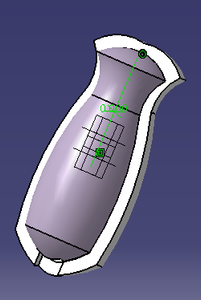

To begin with this project we must know what is 3D modeling. 3D modeling is creating a tridimensional representation of an object using different softwares, for this project the chosen software was CATIA and Solidworks. This technology is used by many areas of engineering, and can be used to fabricated very little pieces such as a bolts or massive projects such as planes.
When finished we get the final piece.
The measurements, as mentioned above, were set taking into consideratiom the average measurements of the adult mexican female.
As mentioned before the platform used in the elaboration of this project was CATIA, but the platform Instructables does not support the extension (.CATPart), so the (.stl) files were uploaded (these extensions is the one you'll use to print in 3D), nevertheless a link with the (.CATPart) files is included (CATfiles). Photos are available.
The handles were designed in such a way that the handle is ergonomic and comfortable to use while maintaning a relaxed grip by being thicker than the standard cutlery set handle.

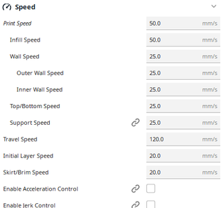

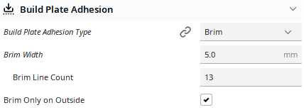

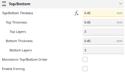

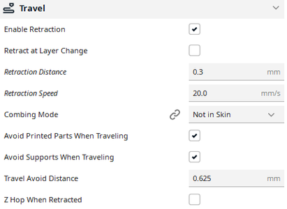

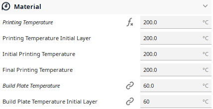

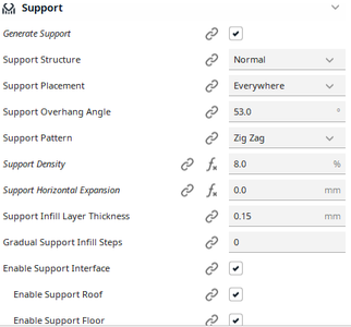

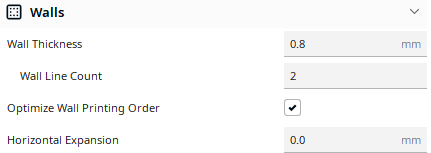

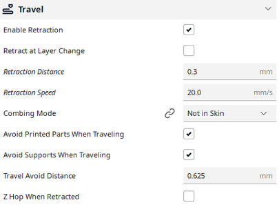

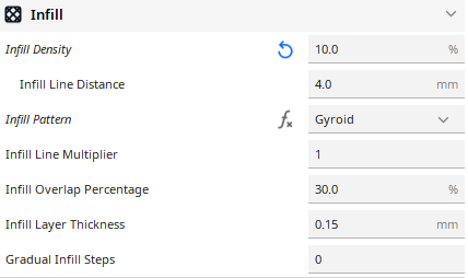

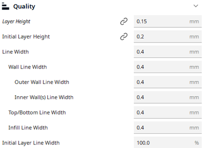

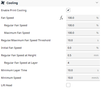

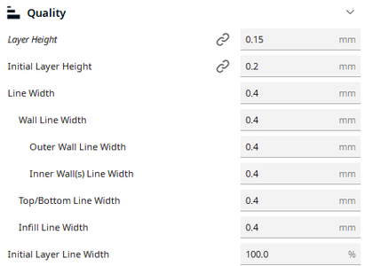

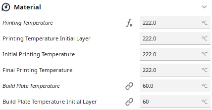

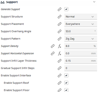

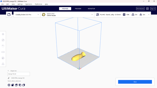

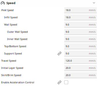

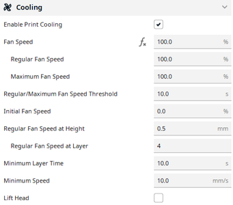

The sofware used here for the printing was UltiMaker Cura, but as long as the values are similiar the printing will run smoothly in any other printing software. To print the object first you must drag your (.stl) file into the software, preferably with any flat surface touching what would be the bed of the printer.
The next step is setting up the printing process. This project can be printed by anybody using the aforementioned PLA and TPU filaments, but in case you have a 3D printer and want to do it yourself the pictures above provide the settings used to do so. Images 1 to 10 pertain to TPU, images 11 to 20 are for PLA.
In the case of the UltiMaker Cura software the next step would be to slice the piece, other programs allow you to directly save as a G code. Which is the programming language which will give the printer the instructions on how to print your piece. You can see an example of a very simple G Code program above.
Once all of the above is ready, the piece is ready to be printed !!

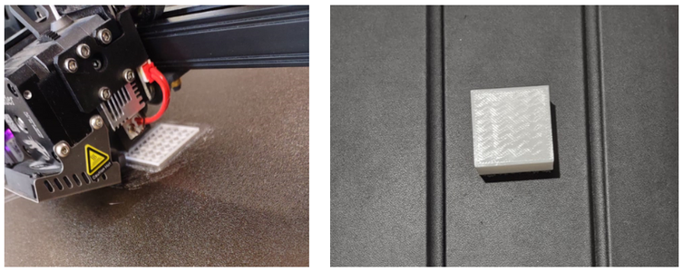

A few hours laters your have your piece in your hands !! Fair warning you might have to do a little very light-handed sanding to the newly printed piece.
NOTE: TPU is a very delicate material, so make sure to use the settings provided, the printing process could have problems. A little advice is to always make a small piece just to test out your settings, like the little cube shown in the picture.
