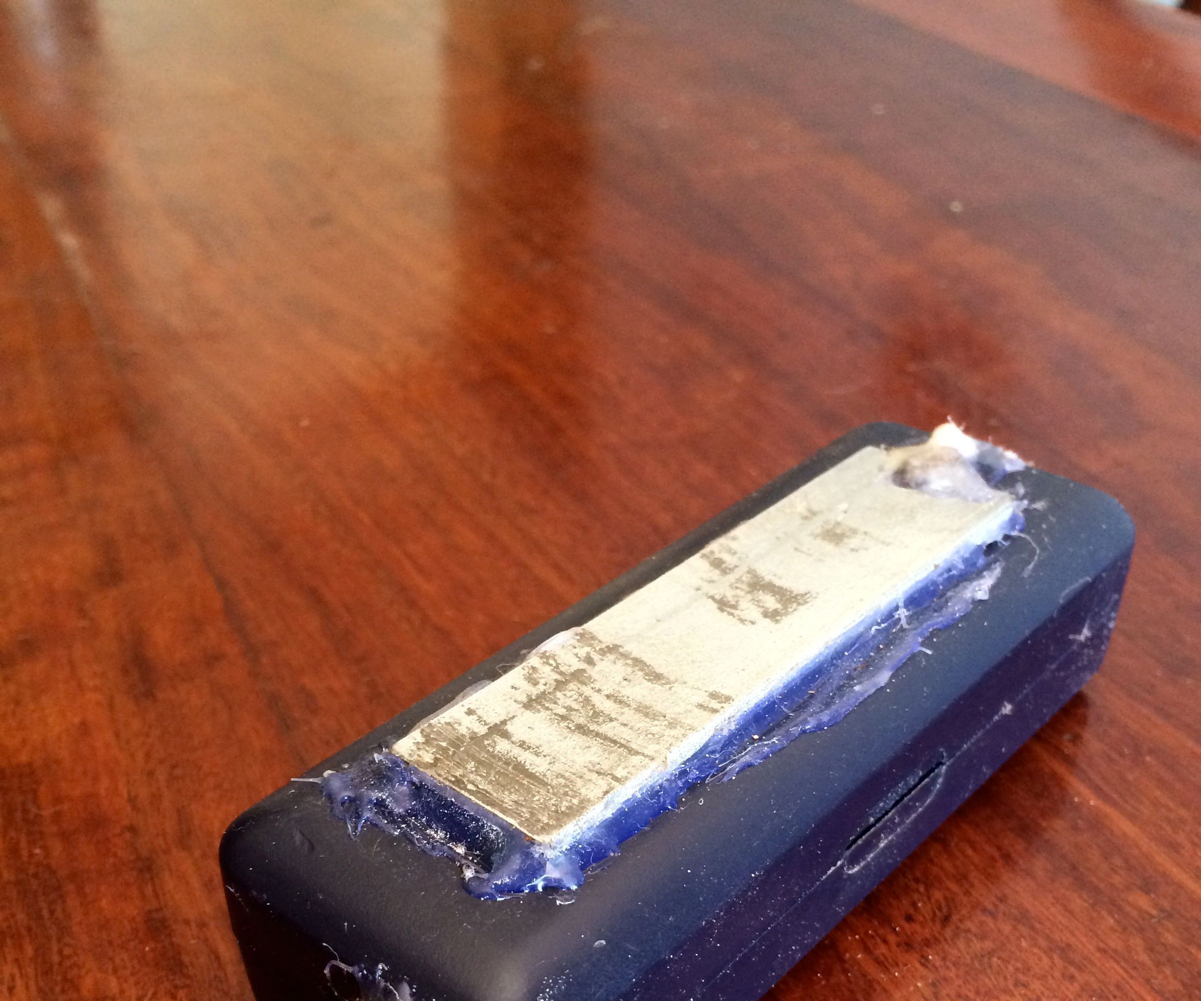

Step 3: Solder and Hot Glue
It is fairly simple to figure out were to put the components so I won't go into detail in that. The pictures may give you some ideas. If you want to put the project in a box you will obviously want to place the potentiometers more conveniently.
Step 4: Finished
Have fun with your signal generator.Here are some videos, one operating a small transducer, then dimming an led, and last I send the signal to my homemade amplifier (I might make an instructable on that to) with the output connected to a large speaker.
