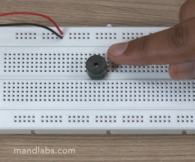

We have further modified to circuit to create different tones. Vary the voltage at Pin 5 using a voltage divider. Detailed steps are available on Poco Club. To join Poco Club, here is the link.
Step 43:
You will observe that the tone of the buzzer sound can be increased or decreased by rotating the preset. When we change the voltage at Pin 5, the duration of charging and discharging cycles is changed. This leads to a change in the frequency of the pulses, and we can produce different tones.
