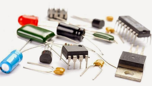

Step 1: Things Required :
- Timer IC : NE555
- Resistance: 10k--2 pieces , 1k --1 piece
- Capacitor : polar -- 10uF and 100uF ; non-polar(ceramic) --0.1uF(2 pieces)
- jumper
- LED
- USB power supply
