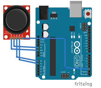

Connect the 5V and GND pins from the Arduino to the breadboard, and connect the VCC and GND pins from the LCD to the breadboard as well. From the LCD connect the SDA pin to A4 and the SCL pin to A5 on the Arduino. On the breadboard, add a push button in the middle and connect a 330 ohm resistor to it, and also connect it to power and ground. Next, connect a wire from the resistor to pin 12 on the Arduino. Additionally, add 3 red LEDs, 1 yellow LED and 2 green LEDs to the breadboard, and connect a resistor to each one. Connect the yellow LED to pin 3, the 3 red LEDs to pins 4, 5 and 6, and the 2 green LEDs to pins 7 and 8 on the Arduino. Finally, connect power and ground from one side of the breadboard to the other to complete the circuit.
Connect the joystick X Y and SW pins as shown above, however, connect VCC and GND to the breadboard.
