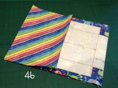

Place the smaller (unfolded) interior piece, and place it over the unfolded exterior end, right sides to right sides (4b). The interior piece should overlap the small folded lip of the exterior piece slightly (4c). This will make the flap.
Pin in place (4d & 4e).
Sew around the three open edges using a 1cm seam (4f & 4g).

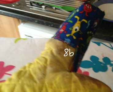

Once you have one complete pouch where exterior and interior are completely joined (8a), you need to turn it right side out and press it. The sewing and turning out process will have left it very rumpled looking, so where possible, pressing is a step that can't be skipped in this case.
This is a really awkward size and shape to press, and as I had no specialist equipment I used an oven mitt to protect my hand while I held the pouch to press (8b). If you decide to do this be extremely careful. This project is not worth getting burned over.

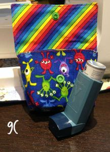

If you want to make a soft pouch for an inhaler (9a & 9b), then go through the process leaving out only the fusible interfacing.
When complete, they look really quite smart! (9b, 9c, & 9d).
