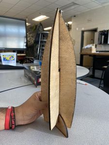

We made a smaller version of the base so that we would be able to see how it could be built without wasting materials. Once we had a design that we liked we were ready to cut the real base.
Step 2: Make the Base

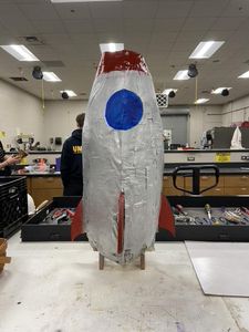

We cut out 2 pieces of wood in the shape of a 2-D rocket ship (40" tall) that were able to be friction fitted together in order for it to become a 3-D stand. To make it look more like a rocket ship it we put little fins on either side of the stand. To have a base for the actual machine to sit on we cut a wood circle to place on top of the already made stand and screwed in in place. (Optional) For decoration we used expanding foam to form the round shape of the rocket. We put paper mache on the foam and then painted it to look like a rocket ship.

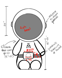

We sketched out the plan that we had for the actual astronaut. The dimensions are not correct because we didn't know we would have a base.

Final step!!!! At this point we should have an astronaut and a stand but now we are going to put it together. Just simply glue or screw the little guy onto the stand. You can decorate him however you like with paint and spray paint. We added a little touch of tissue paper at the bottom to look like the spaceship was on fire.
