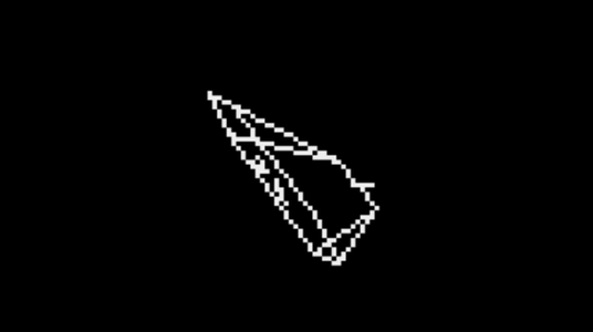

This Instructable covers how I created 3D wire frame graphics (in mode 8) using an Atari 8 bit computer. Speed is key to smooth animation and the 6502 chugs along at 1.79mhz (getting on for about 1000 times slower than a Raspberry Pi), so cheating is in order.
I'm using Action! and 6502 assembly language together with tricks like screen flipping, a new line drawing algorithm, and how to avoid floating point calculations.
Unfortunately the Atari can't calculate and draw lines in real time, so I've split the work in half; Action! generates the points and assembly code draws the lines.
Also due to processor limitations, I haven't considered back-culling or changing the point of view. Welcome to 1983!

The video shows the 3D rotation routine running code generated by Action! with page swapping and the new line drawing routine. The code does the matrix calculations but it's a bit slow. However we can use this to generate points that can be used by a 6502 assembly program.

Drawing the shape
The shape is drawn in an area of memory that isn't currently displayed. When it's complete the display list is re-directed to that area of memory, and the next frame is drawn in a different area of memory. The process is repeated.
We tell the assembly process where to draw the shape by poking $58 and $59 with the memory location. The memory is cleared, and the drawshape procedure is called. Drawshape() takes the calculated points stored in page 6 and draws the shape. When it's finished, the display list is re-directed to the memory
proc drawScreen0()
  pokec($58, screen0)
  zero(screen0,$1000)
  drawshape()
  pokec(dl+4,screen0)
return
