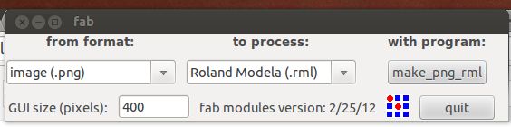

Using fab modules:
From the appropriate drop downs, select "from format:" image (.png) and "to process:" Roland Modela (.rml). You will note that the "with program:" button changes to make_png_rml. By hitting this button you will be offered a new window in which you need to load your png image.
Before making the path there are several parameters you can change. At the top of the window, select for milling the surface of the board. This changes settings to the default for a 1/64 end mill.
Once you have made any required changes, hit the make .path button. Now you can set the Z height of the mill to the surface of the material and create the file to be sent to the mill by hitting make .rml.
The large "send it!" button will begin processing the board.
