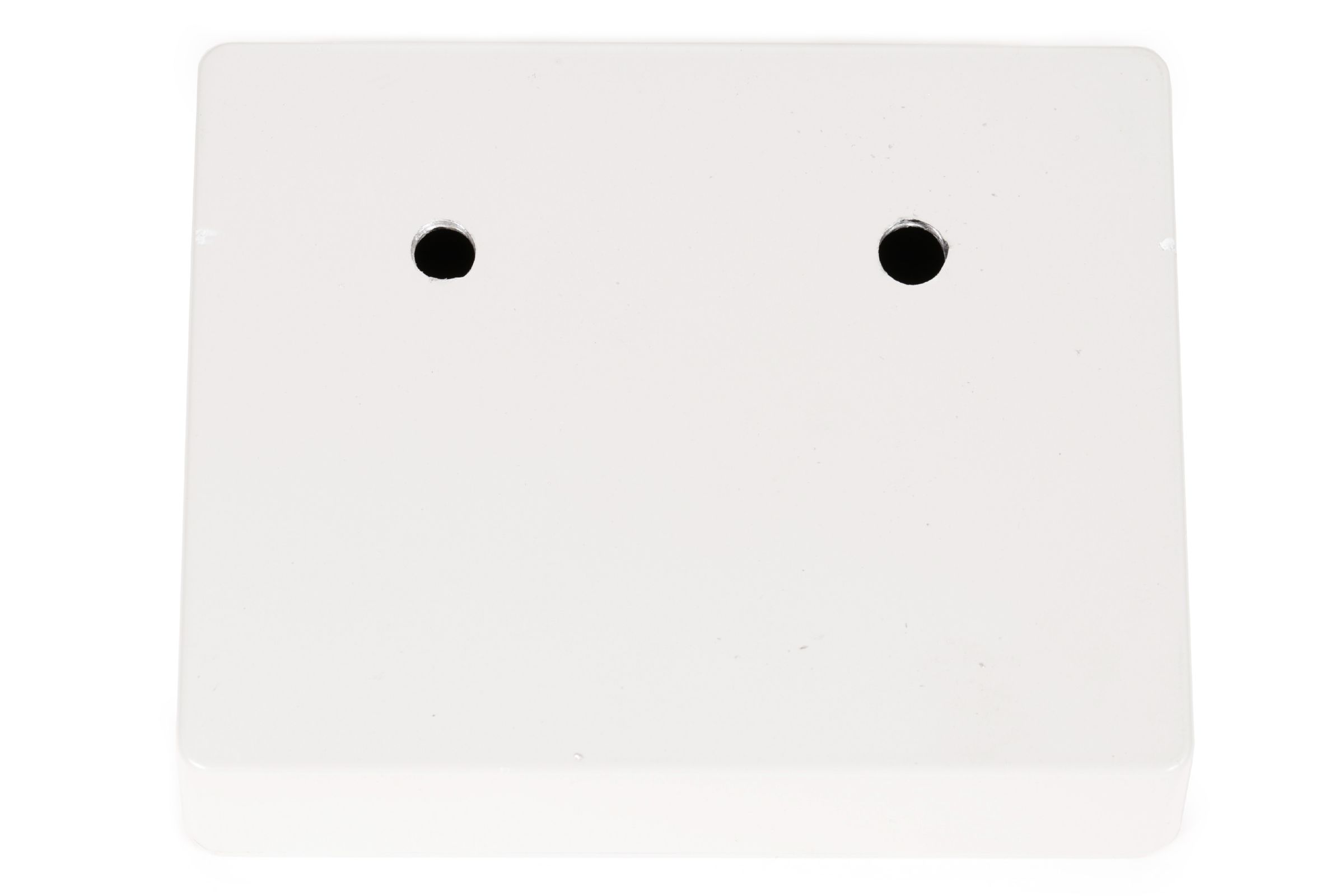

Step 6: Enclosure

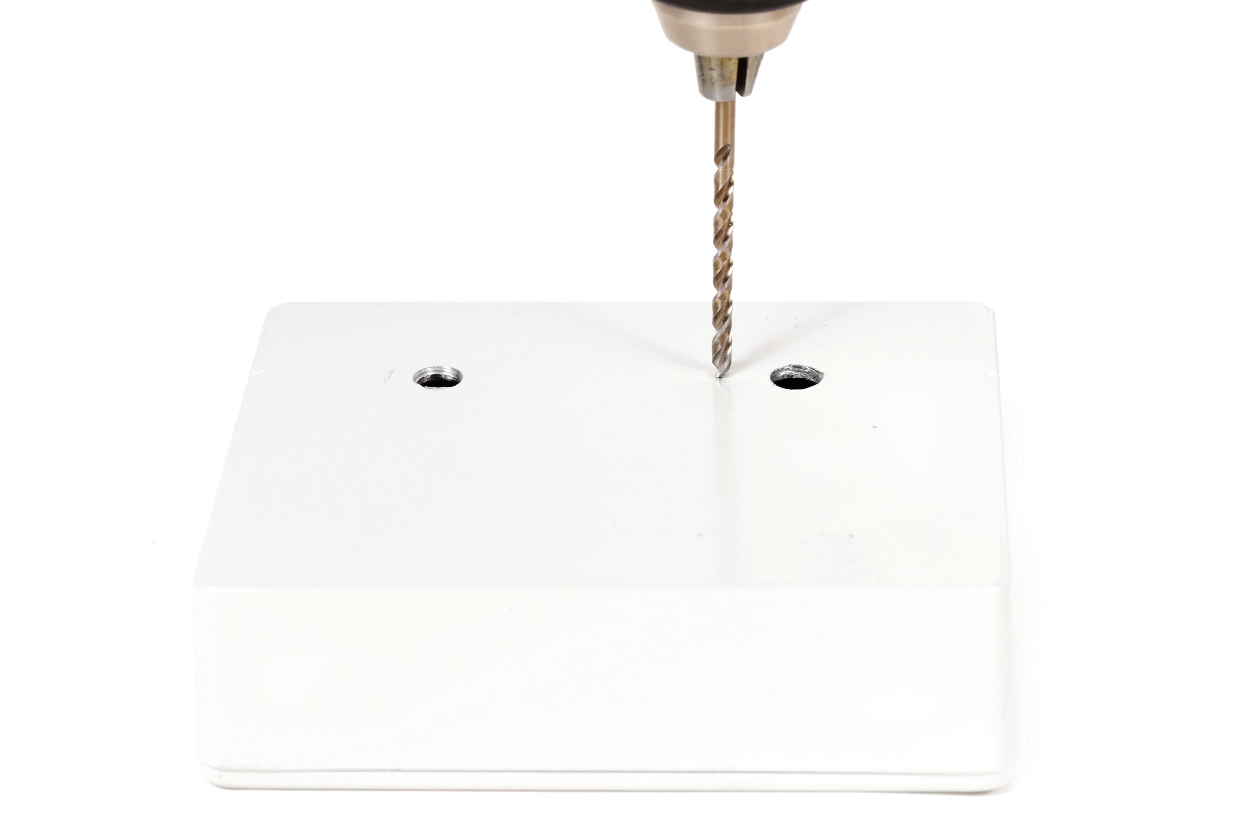

Once again, after breadboarding the circuit, the first thing we are going to do is prepare the enclosure. This is an easy one since we largely just need to mount two potentiometers and a circuit board.

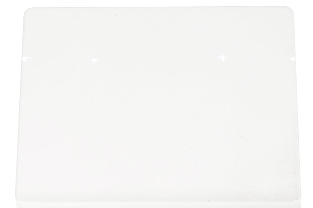

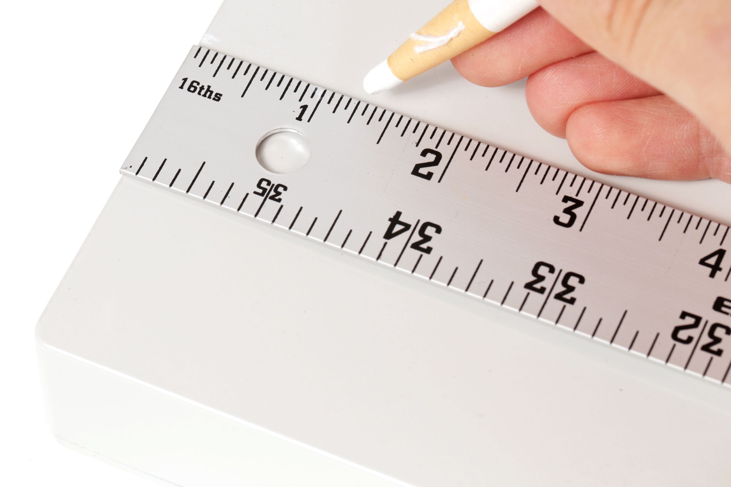

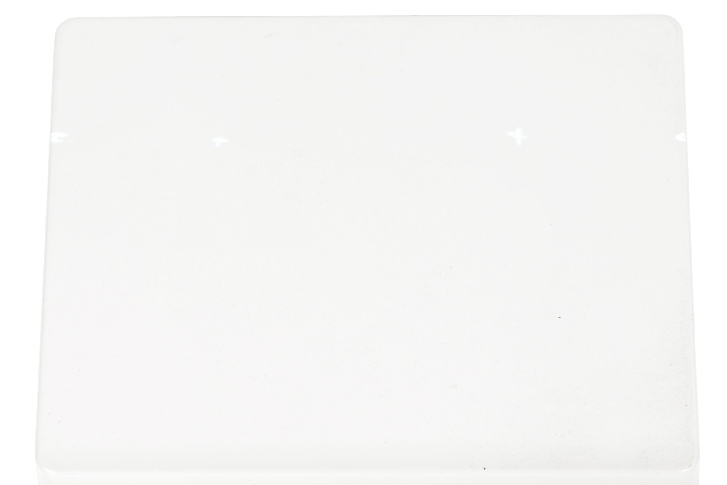

We will start by measuring and marking 1-1/4" in from the shortest edge, and then 1-1/4" in from the longest edge on the face of the enclosure.

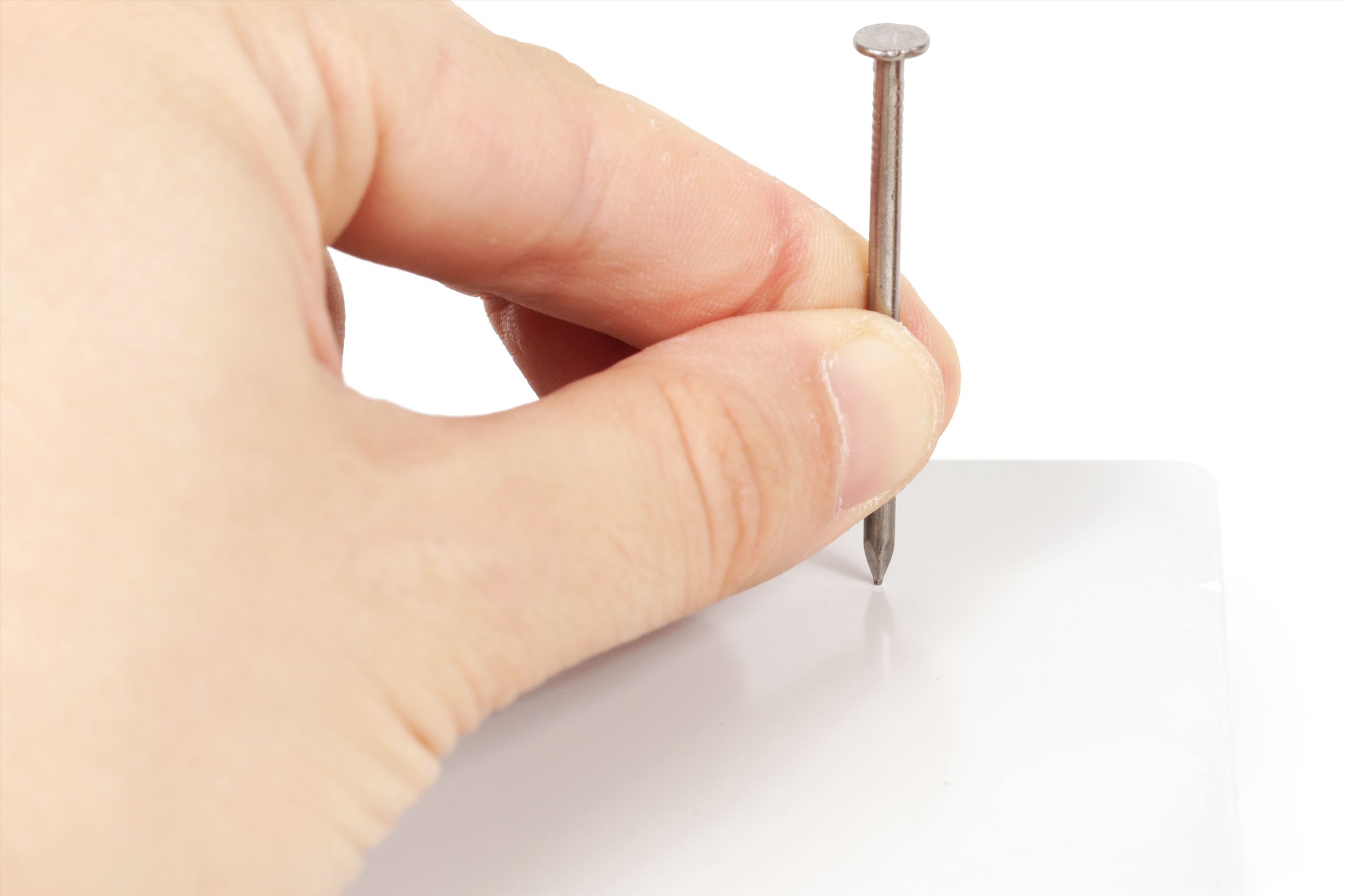

Next, we will make a drill guide by tapping the center of these markings using a nail.

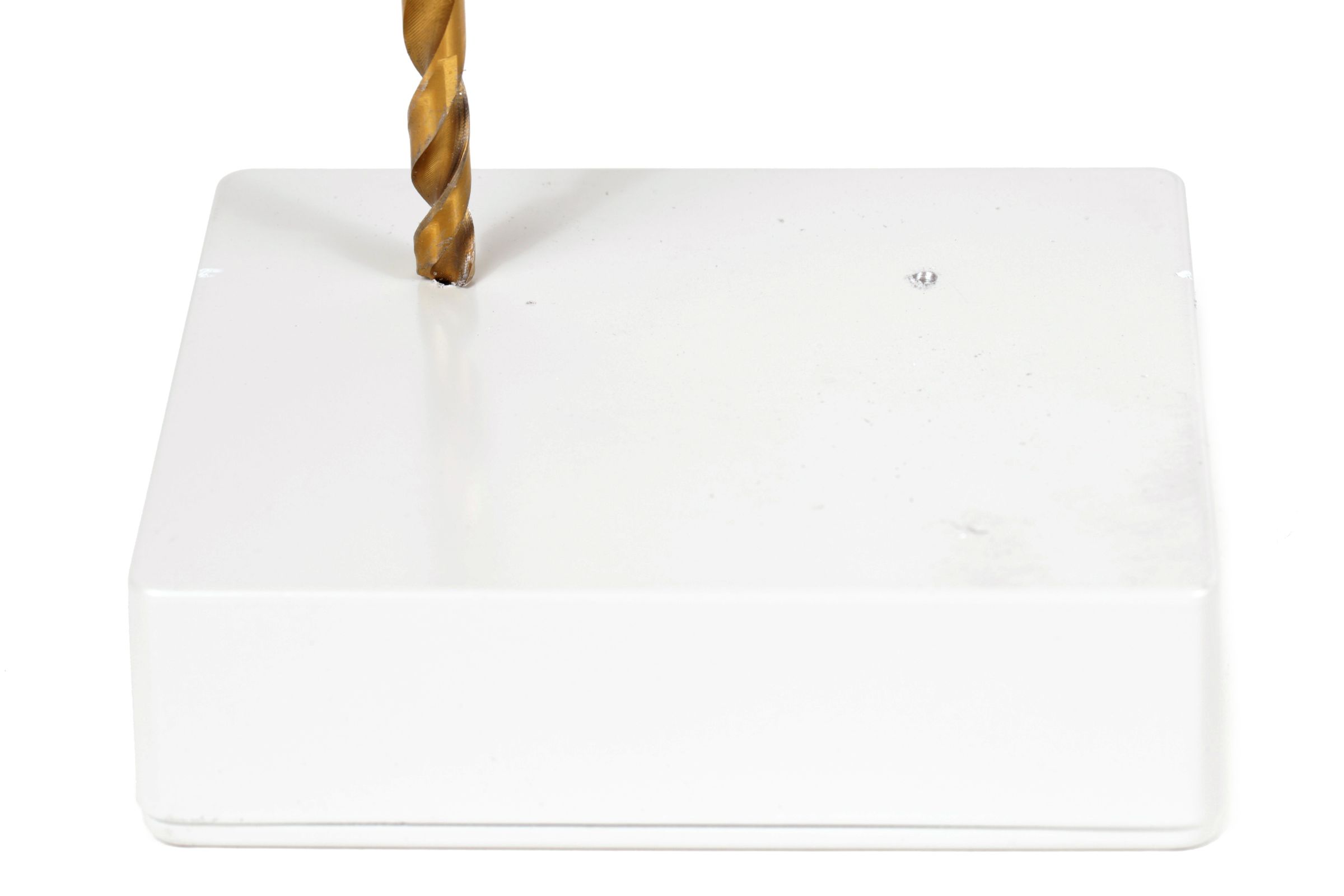

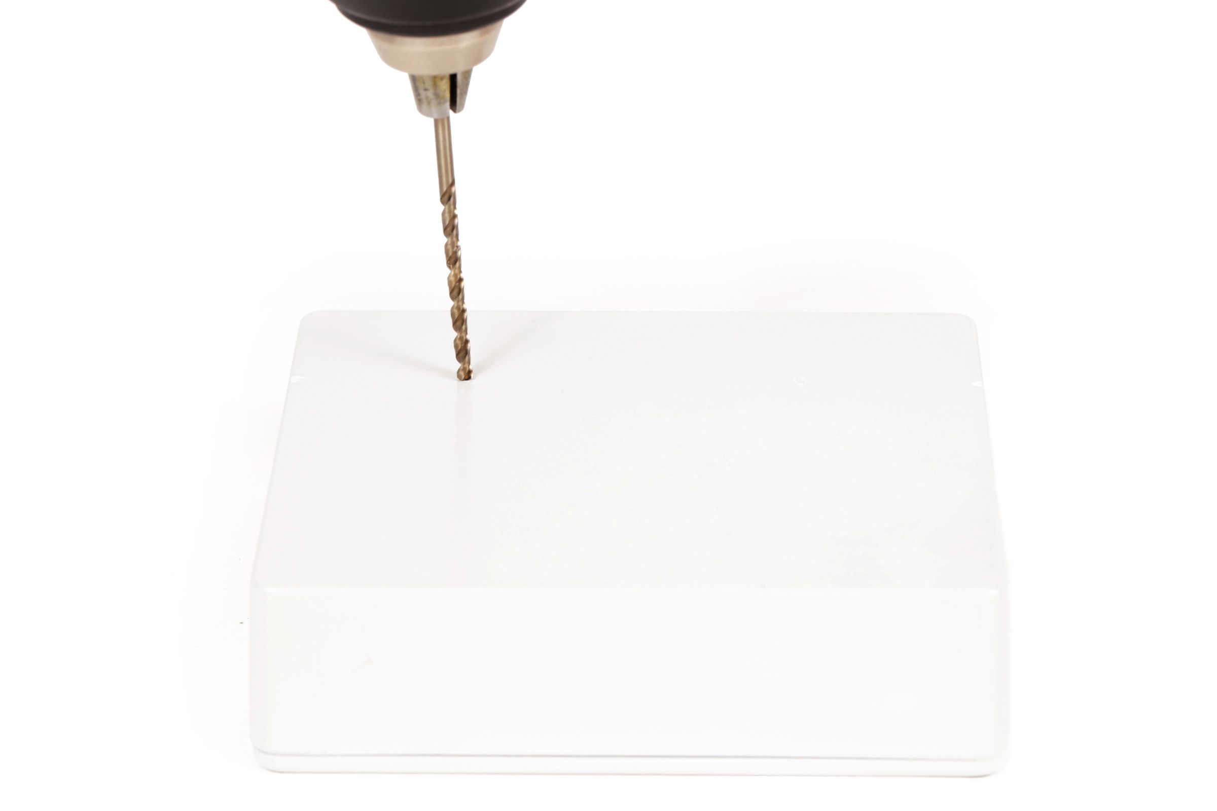

Drill pilot holes using an 1/8" drill bit.
Then, drill the pilot holes to the proper diameter for the potentiometers. In my case this was 9/32" and 5/16". The potentiometer with the switch had a slightly larger diameter shaft.

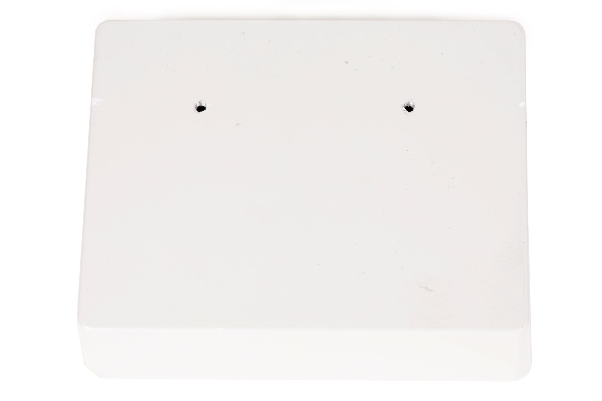

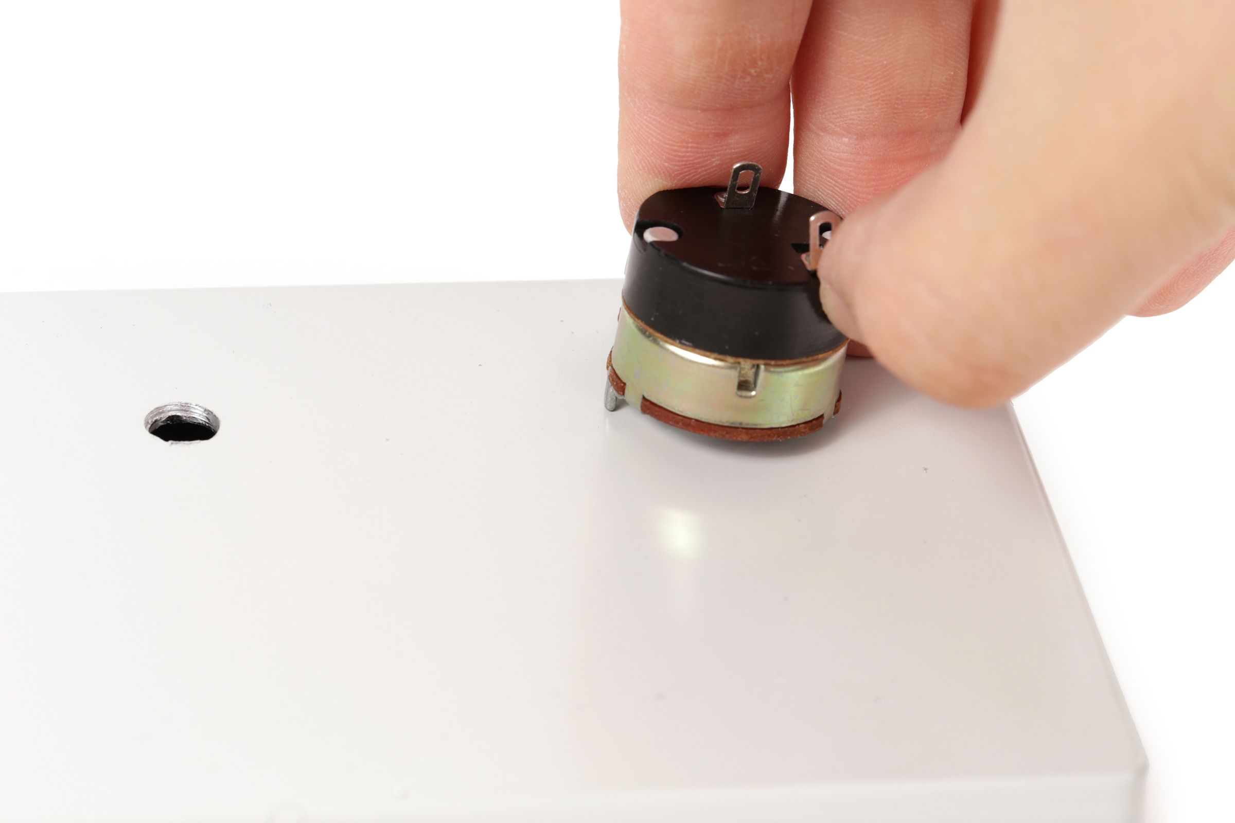

Finally, insert the potentiometers in backwards and upsides down, and wiggle them back and forth to make a small marking for their mounting tabs.
Drill holes for the mounting tabs using 1/8" drill bits.

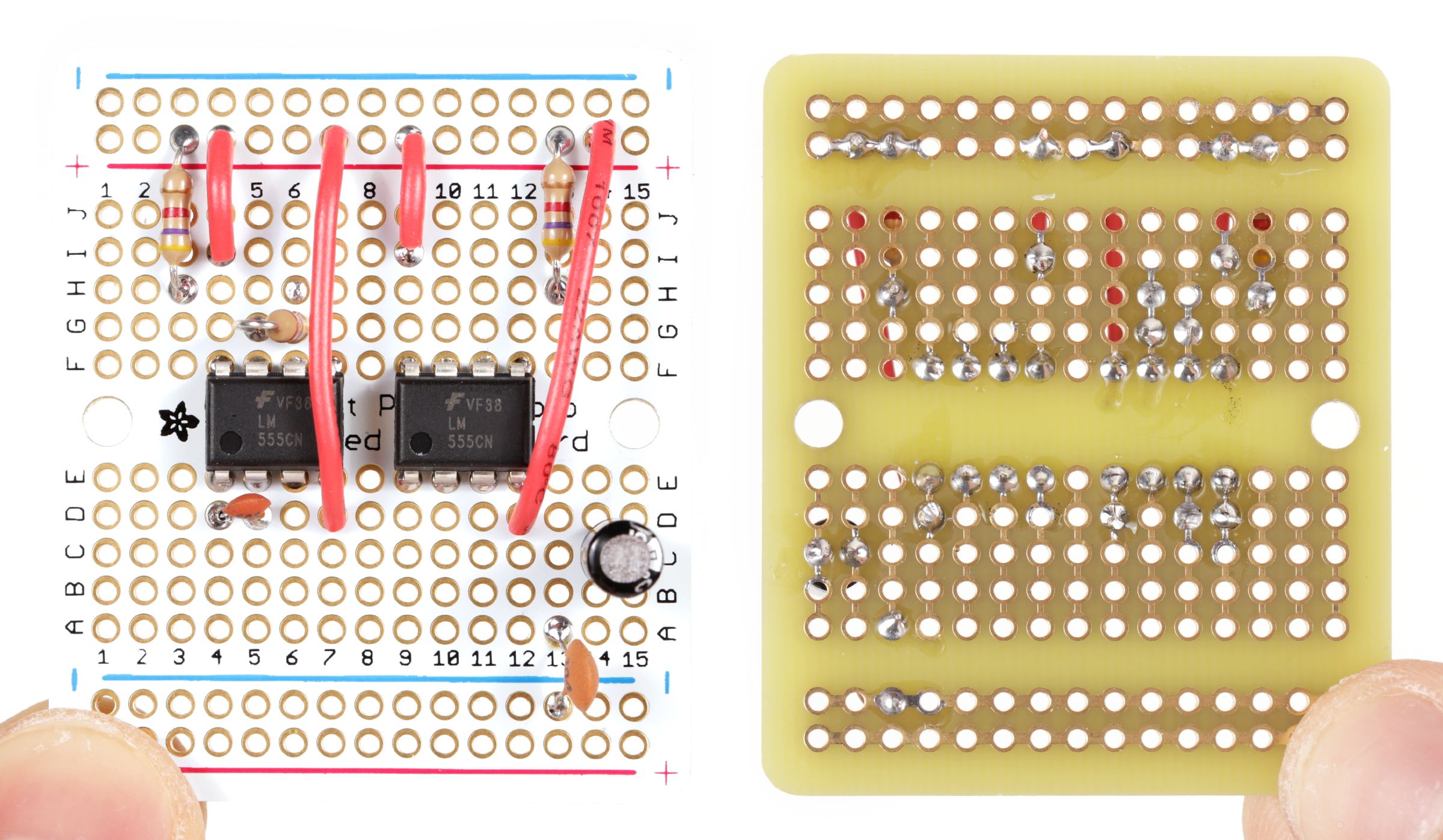

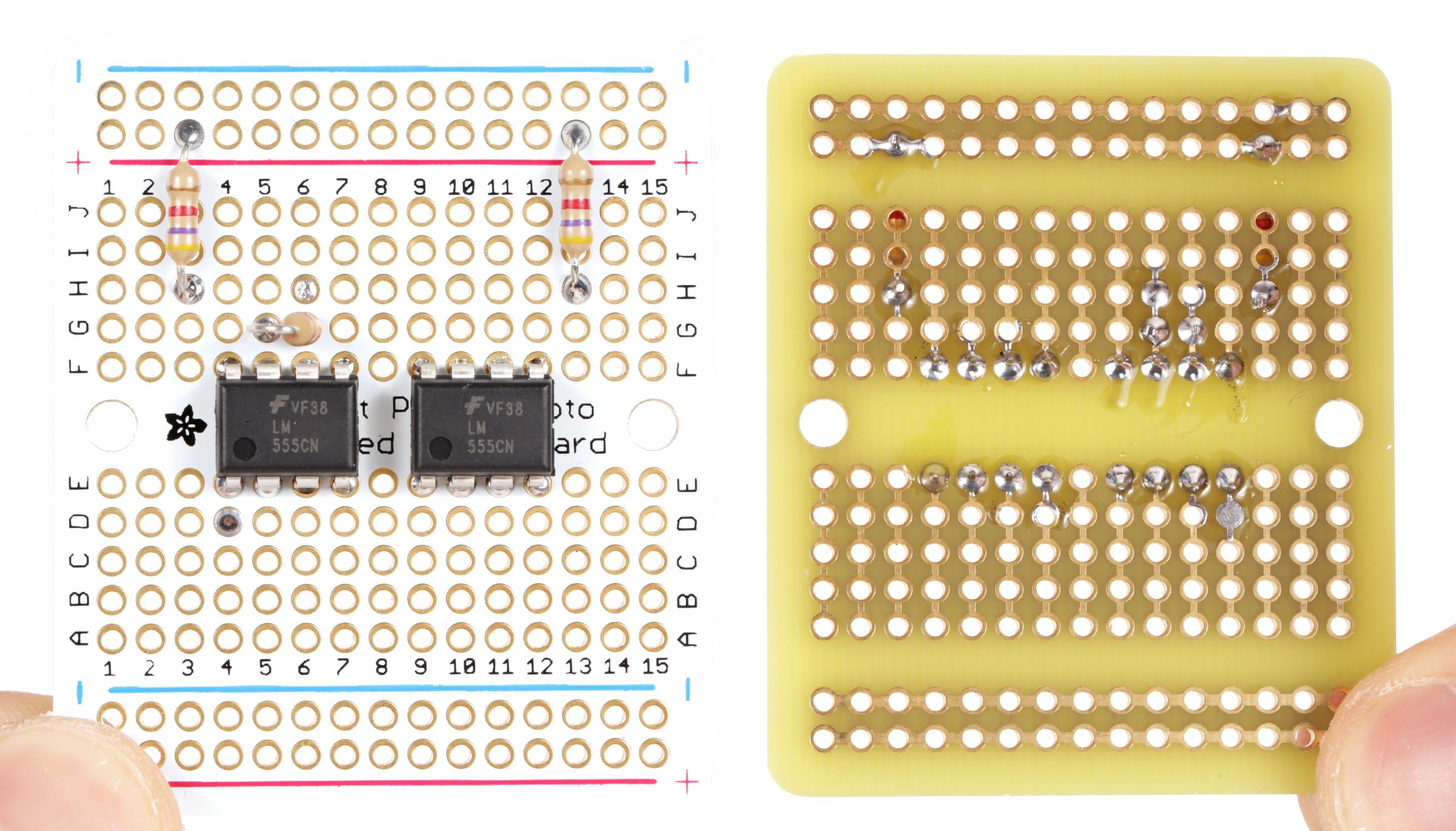

Step 8: Build the Circuit
Hopefully you have already built and tested the circuit on a breadboard. If not, I highly recommend doing that first.
If that is good and done, build the circuit board as outlined in the schematic above. You can double check your work both against the schematic and your connections on the breadboard.
Keep in mind these images shouldn't be used as a guide for building the circuit. These are largely just meant to show you my process for assembling the circuit board and not as the definitive guide for constructing these boards. Always go by the schematics!

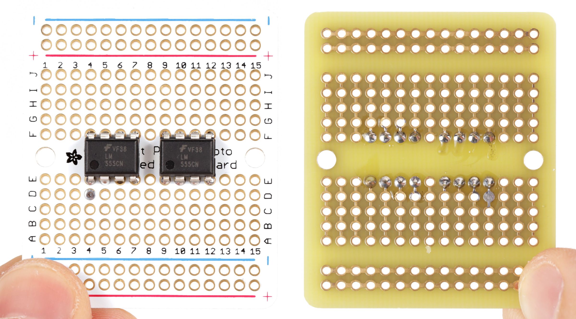

Anyhow, I first attached the chips to the center of the board. This provides a point of reference for all of the other connections.
Next, I attached the resistors.
I then followed up the resistors with all of the capacitors. By now, all of the components should be attached.
The power connections were made next. I counted the number of pins connected directly to power to make sure this was correct.
I then followed an identical process for connecting the ground wires.
Finally, I made all of the other wire connections that were not connected directly to either power or ground, save for the components external to the board.

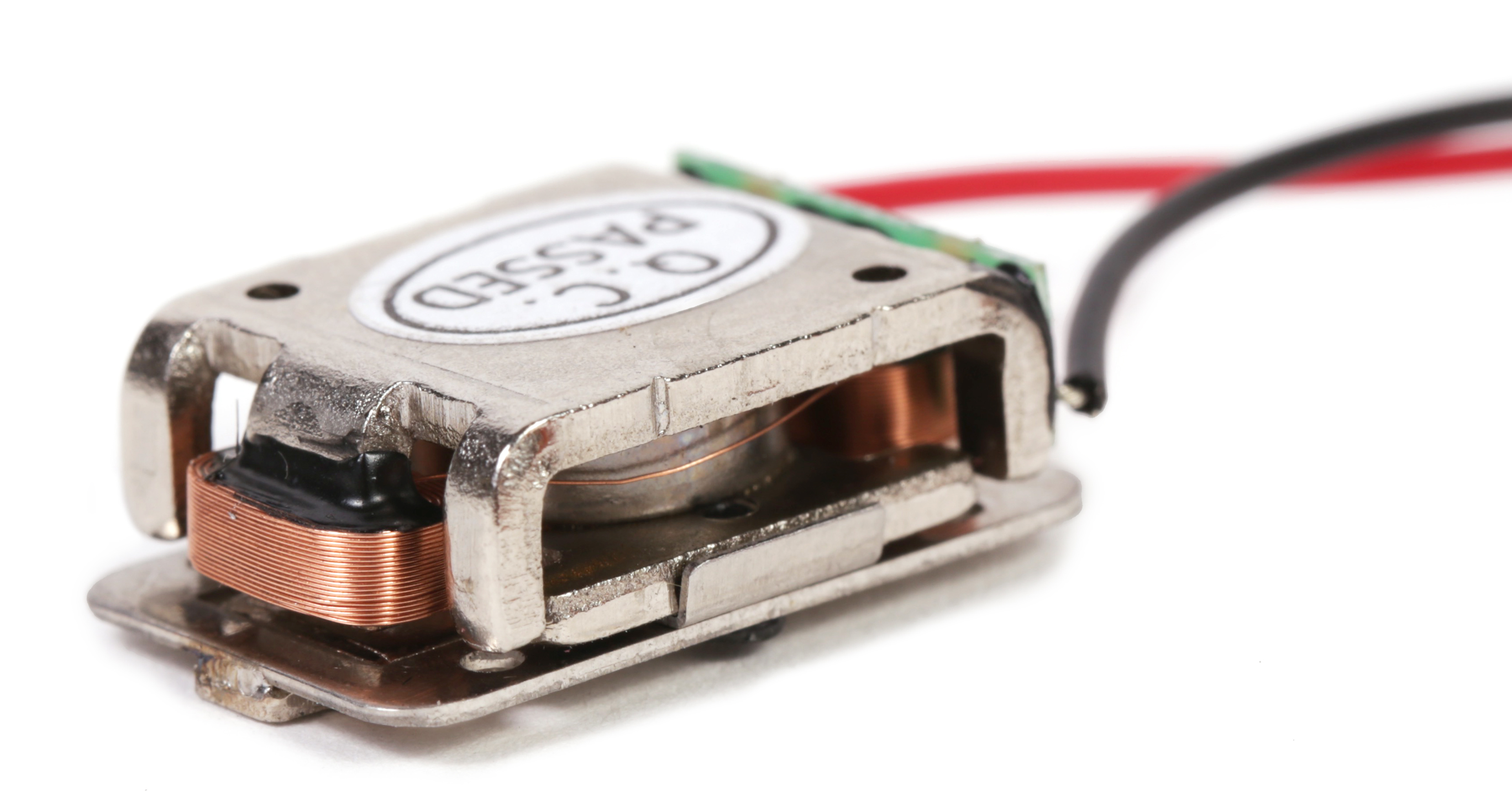

Step 11: Speaker
Connect the red wire from the speaker to the negative side of the potentiometer and the speaker's black wire to ground.
In this project I am using a special type of speaker called a tactile transducer. This is basically a 'contact speaker'. What I mean by this is that instead of vibrating a cone and moving air, it is built in such a way that it vibrates whatever surface it is attached to, and that surface is vibrated to displace air and make sound. This is cool because nearly any solid surface can be vibrated to make sound.
