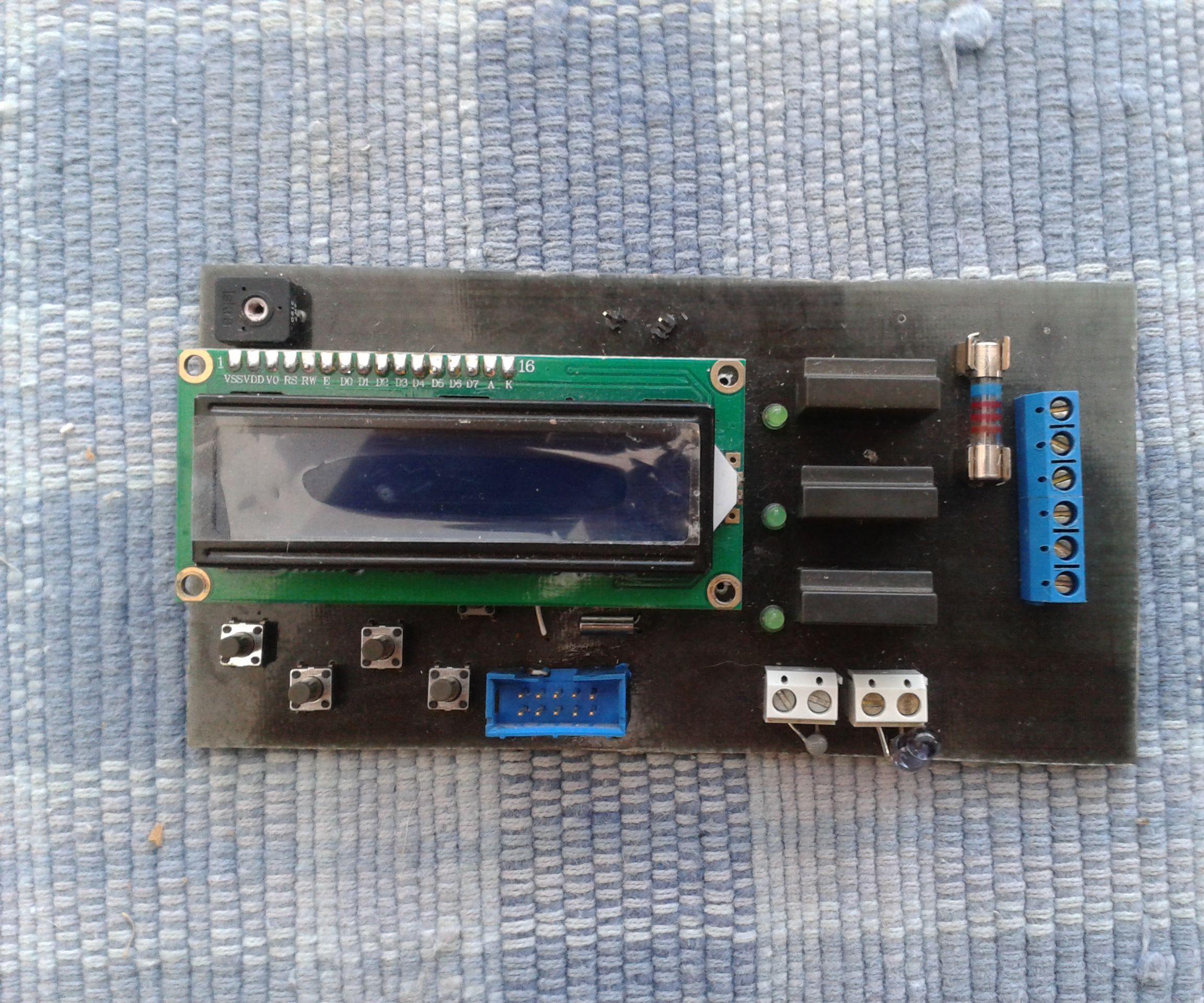

First, let me introduce you my project. I made an Alarm clock with extended functionality & thermometer and humiditymeter. Everything started when my friend (who used to bring me some old electronic rubbish and I used to check if there's not something useful) brought me some cashing register display similar like that. When I first see them I knew that I will made from it alarm clock.
I'm programmer and I used to program in many programming languages but this year I started programming in C for Atmel microcontrolers (attiny 85, atmega 8, atmega 328, atmega329, atmega 128 etc...). When I discovered DHT11 (temperature and humidity sensor) I programmed simple clock with thermo&humidity meter. I haven't got any case for my project so I imagine that when I cut off column from cashing register display case I will have the case of my dreams for my project.
As microcontroler I used Atmega329p because I have and few of them and they got enough pins for my project.

My alarm clock contains real time chip (PCF8563) with backup battery so if once set up right time & date you can turn off alarm clock, leave them for a month without power and when you plugged into adapter again you will have still set right time & date. Each time you change state or time of alarm - alarms are backuped into EEPROM so if you plugged my alarm clock into adapter after long time your alarms are still set right.

I designed PCB of my alarm clock to fit in my case from cash register display so if you want I can send you schematics and you can make your own PCB.
In case you want to etch the same PCB as I have I provide you these to files - toppcb.pdf and bottompcb.pdf in which are my PCB design.
You should print them to the transparent foil or to the very thin paper (Sorry but I really don't know how it's called in English).
If you can you should buy PCB with UV photoresist paint. If you can't you can also buy an photoresist paint in spray and apply them to the cleaned PCB.

You should drill holes for buttons in your case, cut off or add something to the case so the pcb will fit correctly. Before I designed my pcb I firstly measured the case to made pcb design for my own case so if you want to make your own design you're welcome.
As you can see I used old skype-phone headphone to make alarm clock stand. I also attached DC male connector to that stand which provide power to my alarm clock.
