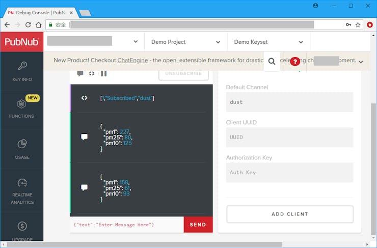

Turn to PubNub, enter Demo Keyset, and click Debug Console on the left, it will open a new page.
Fill your channel name to Default Channel text box, then click Add Client button. Wait for a while, you will see PM1.0, PM2.5 and PM10 value appear in Debug Console.
But it's not friendly to us, so we consider to display it as chart.
