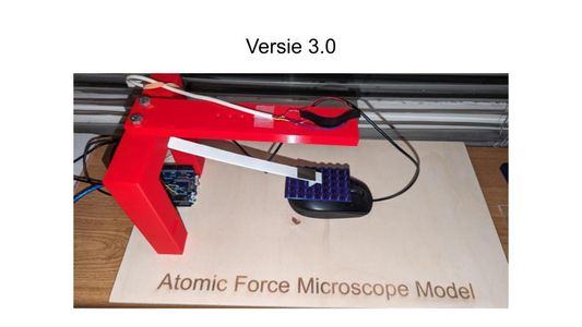

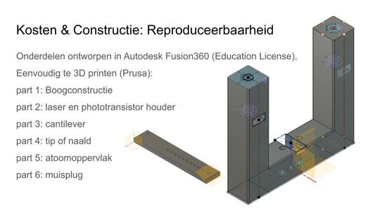

Step 1: Print 3D Parts and Construct
Print all 3D parts. Used .4 nozzle and Prusament PLA.
construct using the m10 and m6 bolts and nuts and using double sided sticky tape.

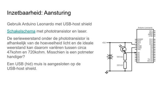

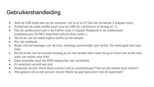

Step 2: Connect Circuit
Step 3: Upload Arduino Code

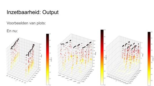

Step 4: Run Python Jupyter Notebook Code

# Plot the filtered data
fig = plt.figure(figsize=(12,12))
ax = fig.add_subplot(111, projection='3d')
ax.scatter(filtered_x_data, filtered_y_data, filtered_voltage_data, c=filtered_voltage_data, cmap='hot_r')
# Set the axes labels
ax.set_xlabel('X')
ax.set_ylabel('Y')
ax.set_zlabel('Voltage')
# Set up the color bar
norm = plt.Normalize(min(filtered_voltage_data), max(filtered_voltage_data))
cbar = plt.colorbar(cm.ScalarMappable(norm=norm, cmap='hot_r'))
cbar.set_label('Voltage (V)')
# Set the axis limits
ax.set_xlim(min(filtered_x_data), max(filtered_x_data))
ax.set_ylim(min(filtered_y_data), max(filtered_y_data))
ax.set_zlim(1, max(filtered_voltage_data)) # Set the minimum voltage to 1V
# Display the plot
plt.show()
Step 5: Manual, Example Data, Uses
