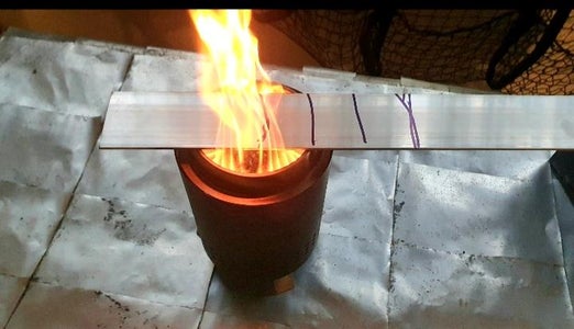

My original idea was to use a pellet fuel stove to provide heat to the TEG. I had thought that if the TEG module was mounted on an aluminum bar, heat going to it could be controlled by sliding the bar. The nearer the TEG was to the flames the hotter it would get. I used a temperature gun to measure how hot different places on the bar got over the flames - the temperature appeared to it vary dramatically, sometimes reading 200c then up to 500c. This could easily cause the TEG to overheat and fail.
A camping gas stove was then tried. The reading looked more constant with the bar reading 200c when over the flames of the burner but then the bar started to bend, indicating the temperature was much higher than that being shown. A more stable and easier to control heat source was required for testing. Tea candles were investigated as a heat source, but it was observed they wouldn't be putting out enough heat.
It was decided, for testing purposes, a fry pan on a kitchen stove would be used to prove a controlled heat source.

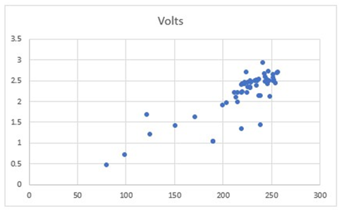

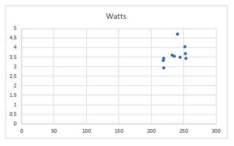

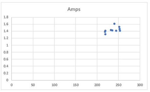

Step 4: Power Readings
I measured the heat of the frying pan using a temperature gun. The Volts and Amps being generator were measured with a multimeter. These were plotted on a graph to see how much power the TEG could generate.
It looks like 4 watts is generated at 200c. (3.2Volts,1.3 Amps). I got the impression at temperatures over 250c the chance of 'cooking' the TEG increased dramatically.
The heat source and water source were applied to the TEG for over an hour at a temperature of 200c delivering a steady output of 4 watts of electricity. These reading were taken while the TEG wasn't powering anything.

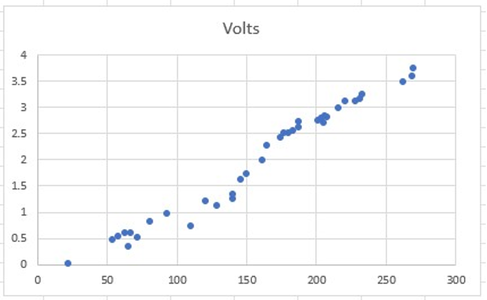

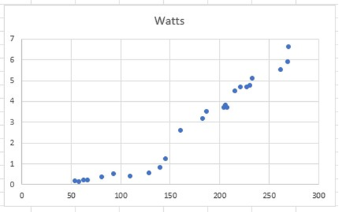

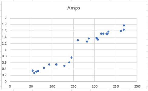

Step 6: Power Readings With Closed Water Cooling Loop
Readings were taken by a Multimeter and graphed. This set up gave a steady 3.5 Watts of power over 90 minutes with a LED torch connected. The water tanks were swapped places about 6 times, but no new cold water was added, the water temperature had increased to 28c at the end. The surface temperature of aluminum heat exchange did not raise above 60c.
