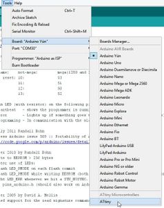

First of all, open the ArduinoISP code example code and upload it to your Arduino.
Then, wire the ATtiny (or use your adapter). Now open the code you want to upload to the Attiny.
This code is going to scroll through 4 different modes when we press the button. In the first one, the LEDs will be all on. If we press the button, it enters the second mode which is blinking. Press the button again and the third mode is fade. If we press it again the last mode is a faster blink and if we press the button again it will enter in sleep mode so it can save battery.
Now you have to select the ATtiny board. To do this go to Tools>Board and there select yours.
After all this, we can click on upload code, wait a few seconds and the code will be ready. You can make changes to your code if you want to change the fading duration or the blinking intervals too!
