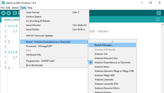

Step 4: Setting Up the IDE
The first thing you need to do is copy open up the Arduino IDE.
Go to File->Preferences
In the "Additional Boards Manager URLs:" paste this:
https://raw.githubusercontent.com/damellis/attiny/...
and click OK
Next go to Tools->Boards->Boards Manager (at the very top of the list)
In "Filter your search..." type attiny. It should only find one selection. Click on it and hit Install.
Once it's done installing, close the IDE so everything resets.
