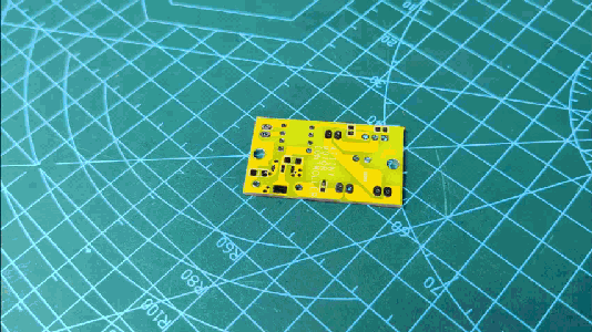

After finalizing the PCB and generating its Gerber data, I send it to SEEED STUDIO for samples.
Ordered PCBs in Yellow Soldermask with white silkscreen.
I received PCBs in a week and their quality was super good considering the rate which was also pretty low.

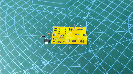

Step 4: Solder Paste Dispensing Process
We start first by adding Solderpaste to each component pad on the bottom side of the board.

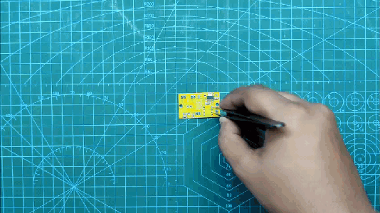

Step 5: Pick & Place Process
Then we pick and place each component in its assigned place one by one.

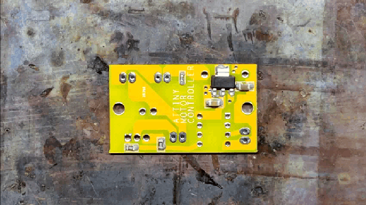

Step 6: Hotplate Reflow

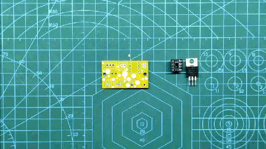

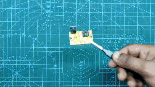

Next, we carefully lifted the whole PCB and place it on the hotplate. I’m using my good old DIY hotplate which I made a while back.
Hotplate Heats the surface up to the solder paste melting temp and it slowly melts. after a few mins when the solder paste completely melts, we remove the PCB and let it cool down for a moment.
Step 7: Adding THT Components
Here's the final setup, we place the remaining two components which are DIP Socket and Mosfet. However, we also add an SMD LED on the Top side with a soldering Iron as well, we cannot use a hotplate for placing the LED as we already place stuff on the Bottom side and this hotplate method is applicable for one side only.

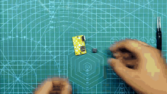

After burning the bootloader and uploading the sketch in the ATtiny13A, we place the Attiny in its DIP Socket and move onto the final assembly of the board.

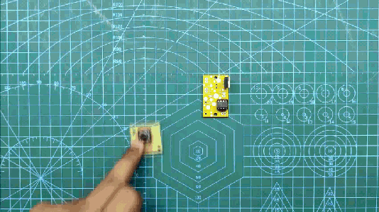

Step 9: FINAL ASSEMBLY STEP 1- Adding Switch
We start by adding a Tactile switch to the circuit's Switch Connector.
A CN2515 connector can also be used instead of direct soldering the switch.

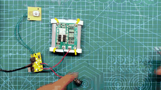

Step 10: STEP 2- Adding Motor
Next, we add DC Motor to its assigned connector pins, I'm manually soldering the wire instead of using a connector, the main and final version that I will use in my Bladeless Fan project will have connectors and wire harness and won't have any solder joints.
Step 11: STEP 3- Adding Battery
We then add the battery's Positive and Negative terminals to the battery connector in the right polarity. Now the circuit is alive. However, there's the last thing left to add which is the charging port.
Step 12: STEP 4- Adding Charging Port
At last, we add a barrel DC Jack to the charging port so we can later add a 12V Adaptor for charging the battery.

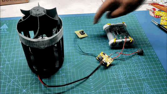

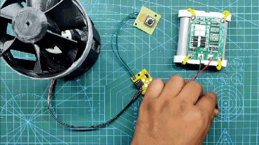

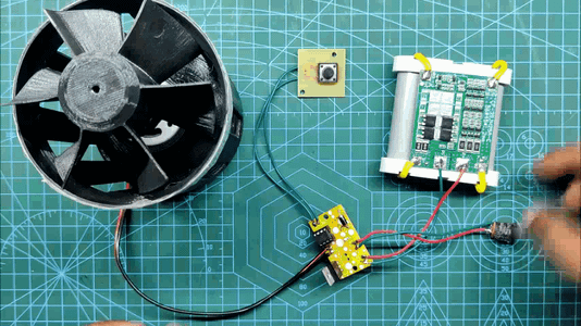

Step 13: RESULT
Here's the result.
As soon as we press the switch, the motor turns ON at max speed.
The second Tap reduces its speed by 50%, the third Tap turns everything OFF.
Its working is pretty simple and if we want, we can add more modes like increasing the Motor Speed by adding more Tap function that increases or decreases the speed of the motor.
Because we are using IRFZ44N Mosfet, we can drive the motor up to 55V at 49A which is insane but it would require a huge heatsink as we increase the motor power.
In my case, Motor Draws 12V at 0.500A at High Mode which is pretty low and sufficient for my application.
As for the alternate use for the circuit, we can use this circuit in anything that operates over 5V, Lights, motors, and even resistive elements.
Just make sure to add a heatsink if the load is heavy.
