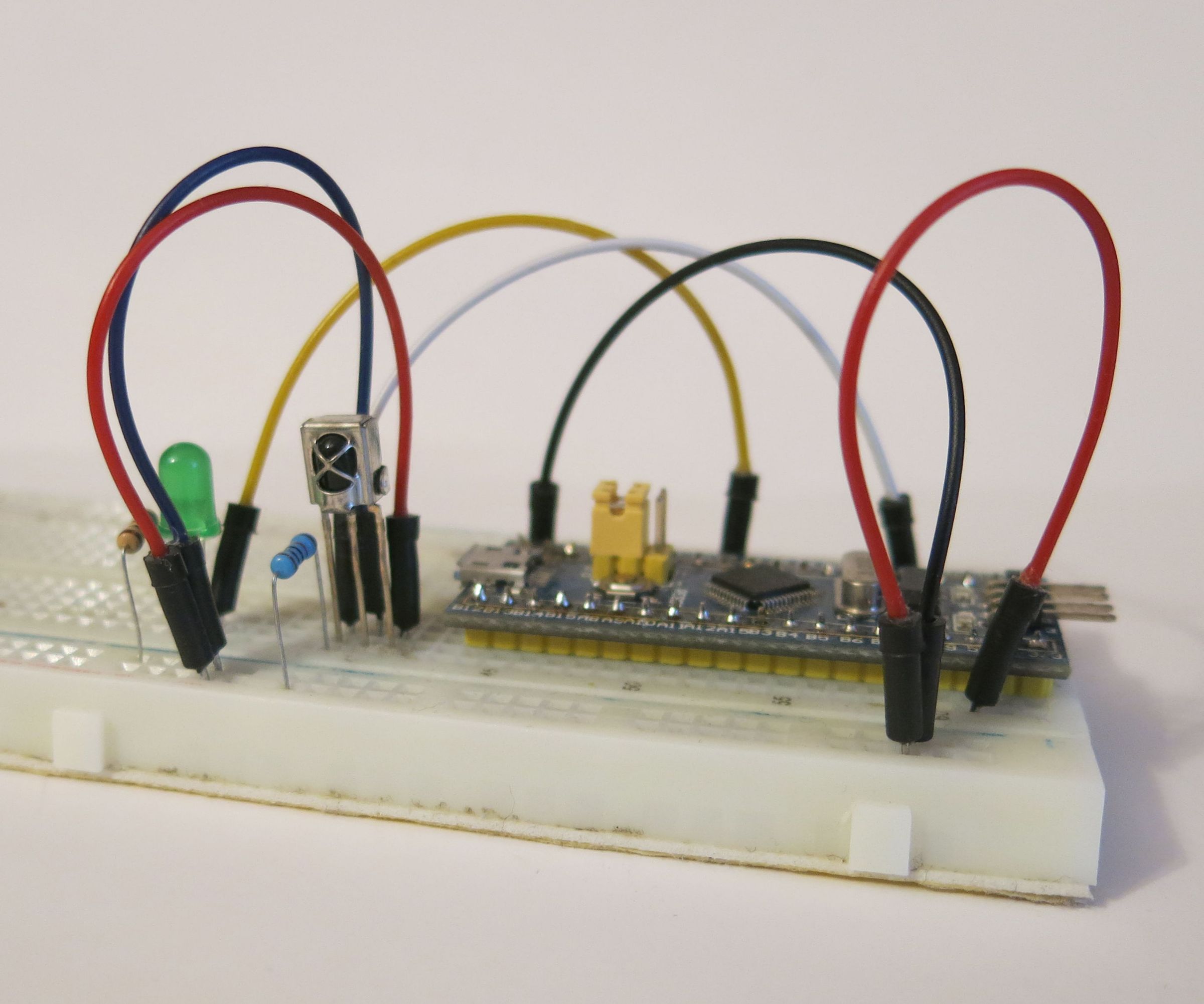

Step 2: Hardware
First, we need to build the hardware platform for our sensor. Here you can see the simple schematics, that can be easily implemented on general PCB or you can use custom PCB using my design. Two AA battery pack provides sufficient power for the sensor during six month or so. To evaluate the remaining battery capacity, internal reference voltage is used, which supplies stabilized 1.1 volt. The readings from this reference voltage source depends on battery voltage, so we can estimate the battery capacity. Here you can find detailed description of how to use this reference source.
Step 3: Attiny85 Challenges
attyny85 is small micro controller and has limited capabilities. It does not have hardware UART port helping debug the firmware nor hardware i2c bus. Hopefully, the sketch developed for the Arduino micro controller, required a cosmetic changes and there is good TinyWireM library that simulated i2c bus on the attiny85. pins 5 and 7 of the attiny85 used for i2c communication. The standard library for si7021 sensor should be modified slightly: you must remove #include line from the .cpp library file. The library header file has correct include statement in case of attiny85 controller.
To reduce the power requirements of our sensor, Attiny85 controller configured to use internal 1MHz clock. Also the sketch implementing watchdog timer that wakes-up the controller every 8 seconds. This aproach allows significantly reduce the power consumption of our sensor from 1mA to about 5 uA (micro Amps, at 3.3 volts).
At the beginning, I tried to use pure Oregon protocol library written by Domonique Pierre. Unfortunately, the controller speed was not sufficient to send the data in the time limits required by the protocol using digitalWrite() system call. To make the library faster, direct port manipulation was implemented in the sketch. In the attiny85 controller there is one output port only, D. So the direct port manipulation class is very simple. The constructor for OregonSensor class automatically selects appropriate port based on the transmission pin number. There are direct port manipulation functions in the class to send "one" and "zero" signal according by the Oregon protocol that allows to speed-up the signal transmission.
