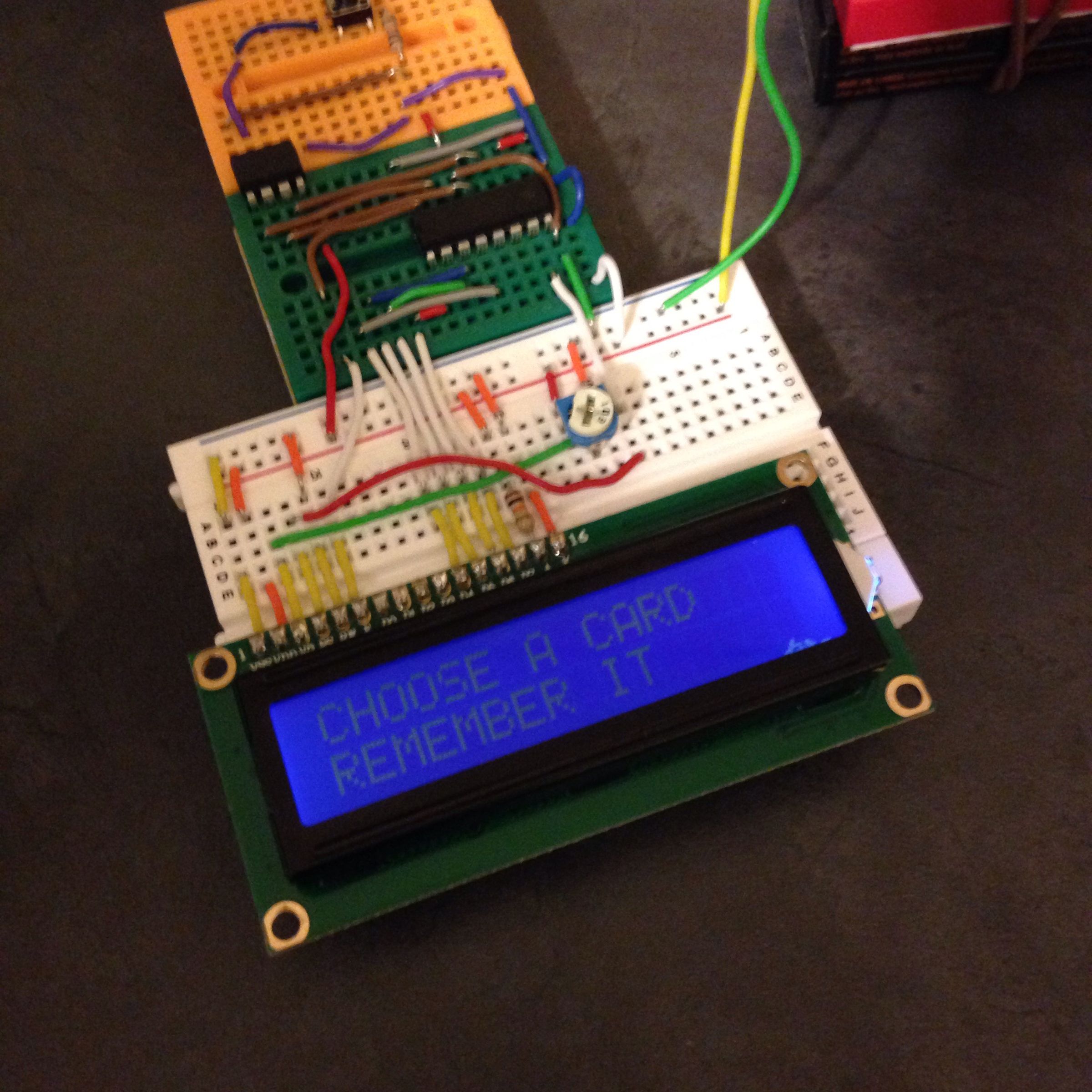

This instructable combines a few instructables projects that I have done into one. It starts off with a 5v power supply I breadboard with a 9V battery, 7805 regulator, switch, 2 10uF electrolytic caps, 103 ceramic cap and just for visual confirmation a led and 330 resistor to detect when the power is on. Then the LCD is wired up to a 74HC595 shift register. The LCD via shift register is attached to the attiny85 along with a 100k Ohm potentiometer. Before I actually hooked up to the attiny I had to wire up a little attiny programmer to the Arduino and upload the sketch. Then i could transfer the ATtiny to the project breadboard. (I uploaded and transferred too many times during debugging)

This instructable consist of several smaller instructables working together.
5v 7805 power supply
1602 LCD
74HC595 shift register for LCD*
Attiny85 micro controller over Arduino programmer
*I've noticed while I was making the shift register for the LCD that there is a transistor that the shift register controls when to turn on/off the backlight of the LCD. I wasn't sure if it would be needed as I elected to have my LCD backlight stay on.

The potentiometer's analog reading is sent to the LCD via the shift register noting direction of left/CCW or right/CW (to potentiometers orientation) by comparing 2 variables of current value and previous value. When both variables are identical representing no change, the LCD displays STOP.
I like my breadboards to be neat and modular for easy storage and hookup. It helps when you're trying to troubleshoot and if other people are trying to do the same. I'm not posting any schematics because all of the different hardware modules are fairly common and there are instructables on them. I may at a later time if requested. Just leave a comment. I'm not sure of any real world applications this instructable would relate to, but I'm sure with some modification to the code you could display any kind of analog reading whether it be temperature, light intensity, distance, pressure, etc.
