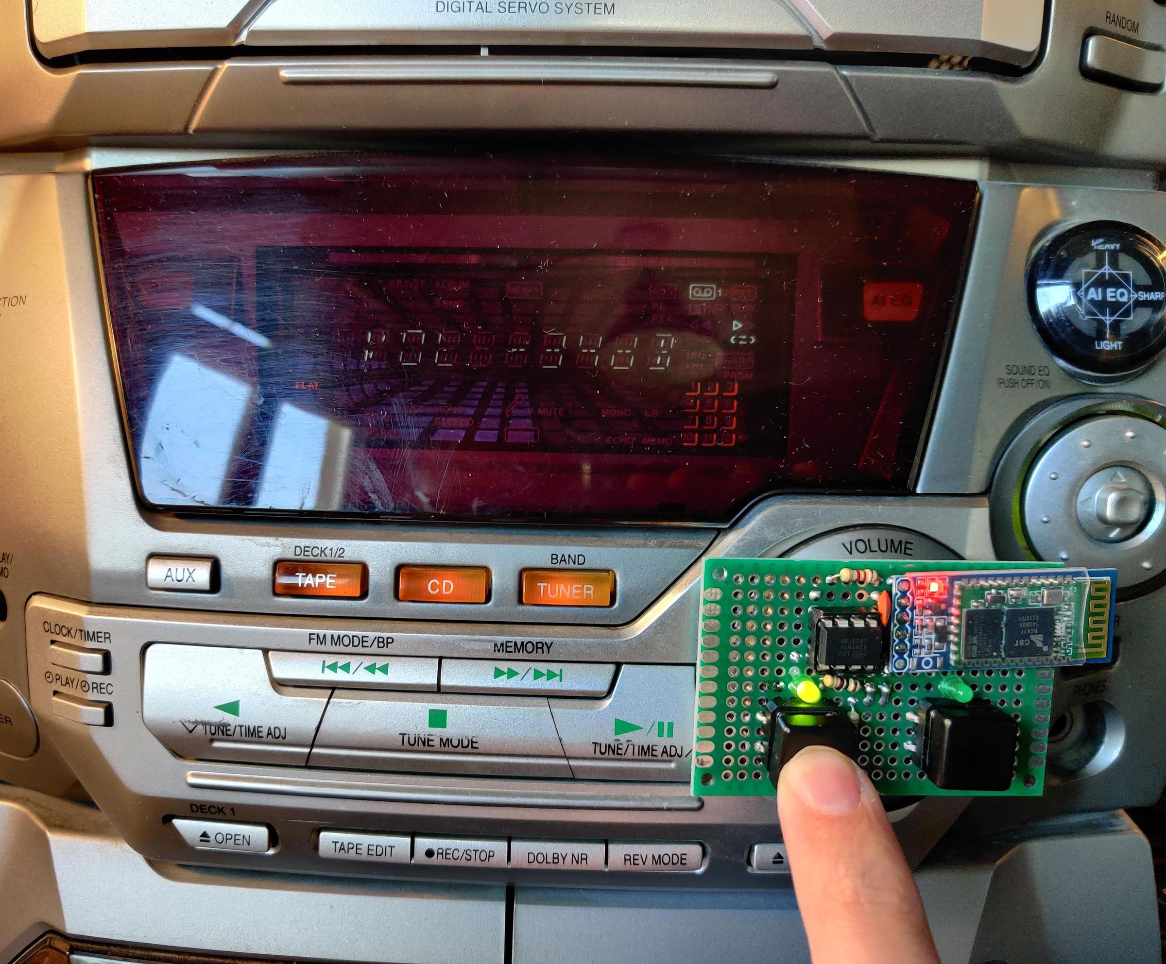

You can see a sample usage in the pictures above. There's my stereo system with a custom volume control module (if you're interested in making something like this, I described it here: https://www.instructables.com/Custom-Volume-Control-for-an-Old-Stereo-System-Wit/).
The Attiny85 that runs the volume module was removed from its socket on the module and placed on the Attinyuino™. The Attinyuino™ pin extension header connects to the board on the stereo in place of the Attiny itself, so the Attiny can still control it, even when placed on our development board. It's also connected to an external BlueTooth module on a breadboard and to the PC, so code can be uploaded to the Attiny at any moment and tested live both on the stereo system and the external BT module, without removing anything.
